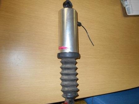

If the unit has a progressive style air shock (see picture below), they are no longer available & Progressive no longer offers a repair service for them (they claim the vendor that supplied parts to make these no longer does so). Which means if you have a shock issue you're going to have to get the coil over shocks for the more current kits AND an air bag retrofit package to convert the suspension over (does require welding on the frame and rear end). If the bike was converted prior to 2006 it would have these shocks unless it's already been updated by someone.

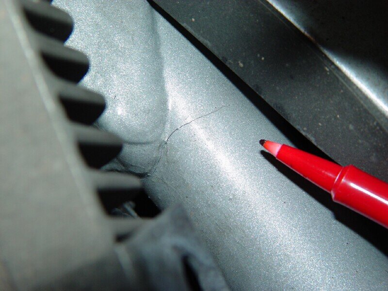

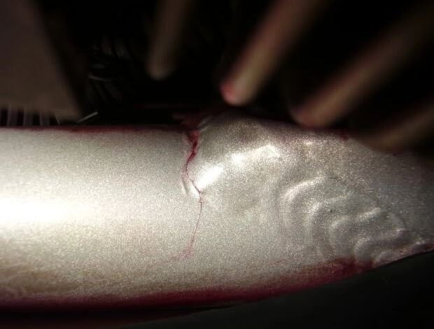

Inspect the motorcycle frame below the battery box & on the other side in same area. 05-dn GL1800 frames were "weak" in this area & well documented for cracks which are signs of a sure to come major issue. I found the below pictures with a basic internet search to reference. The "cause" when it was happened was pretty heavily debated in multiple forums & discussion. I can't tell you "why", but I know it's happened on 2 and 3 wheel motorcycles alike (a few 2 wheel bikes didn't have a trailer hitch added either, which adds to the "why" questions).

Not trying to "overload" or create a paranoid concern, but these are all things that are worth being aware of & knowing about before hand. These are all things that need to be considered and or looked at no matter the trike manufacturer or bike. Every "major" trike mfg out there makes a quality conversion, but they are only as long lived as the care taken to keep them up.

Clearly I needed more coffee when I posted that dang novel! I was clearly stuck on "GL1800" and clearly missed that huge glaring 2000 year model on the post...
Ignore the entire part about the frame, that's not relevant for a GL1500.. Next time I'll drink more coffee before posting replies!
