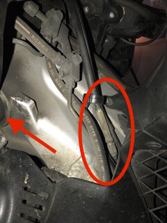

Did a search for this and didn't find answer I wanted. I have a 1/4" or more free play in throttle. Aggravating when wanting to finesse at slow speeds. The top cable has almost all of threads showing. I go any farther and I'm out of threads. Exactly where is the place by front forks where I've heard is the major adjustment point? Any help will be grateful. Thankyou
The short answer is in the red circle below. For a reference, the arrow is pointing to the lower triple-tree bearing and is taken from the left side of the bike.

I had to do the same adjustment on my trike. It can be a bear to get to, but it's doable. Keep small children away as they may pick up some adult vocabulary during the process! ;)

Does all the Tupperware have to come off??
Or can it be gotten at from under the bike??
