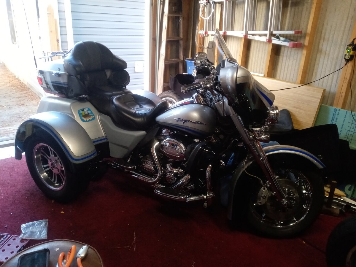

Hello to all out there in trike land.i recently did a trike conversion on my bike and wanted to share a few things I learned.
1: As far as ripping out the old rear end on the bike and installing the trike rear end if you are mechanically inclined it's not that hard.
2: You will definitely need to get a rake kit new triple trees which will give you 5 more degrees in the rake I got mine from Papa Zook with Cut and Shoot Customs. Great guy you can actually call him for help and he will answer your calls. If you don't install it you will have a terrible wobble once installed it's like power steering thanks Papa! and once again pretty easy to install.
3: Rear lights you will need a converter box that hooks into the existing harness to make all the rear lights function properly.
