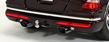

The Tail/Turn Lights come from Honda saddlebags and are removed by loosening the nuts inside the wheel well to allow the light to pull out for access.
Here is a photo of the light bar provided as an accessory and here are its wiring details:
http://www.californiasidecar.com/downloads/Cobra_LIGHT_BAR.pdf
There are also 2 reverse lights that may or may not be hooked up. (ON RETRO INSTALLATIONS, RUN REVERSE LIGHT WIRES FROM EXISTING WIRES FOUND IN THE WHEEL WELLS.)
If it is another style of light.. need a photo.....

Bottom lights are like one in picture, the rubber gaskets surrounding it on the inside of the wheel well are shot - need new ones. Will get ahold of CSC. There is wiring running to them with somekind of bulb. Will need to jack back end of trike up to get at stuff.
As far as tail light assembly, are there just a couple nuts holding the assembly together ?
Take nuts off and assembly pulls out the back ?
Looks like someone covered them up with somekind of rubberized gunk.
Thanks for info
ljs
FYI, I do not have light bar, but I do have the two other individual lights - reverse I guess.
