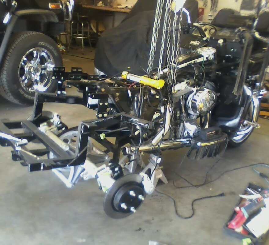

jack stands sit neatly under the frame, axle and swing arm fully accessible.
Weight is off the chain hoist. If the rear wheels were on it, it would be a balance point and I could lift the whole machine off the ground with the hoist.
