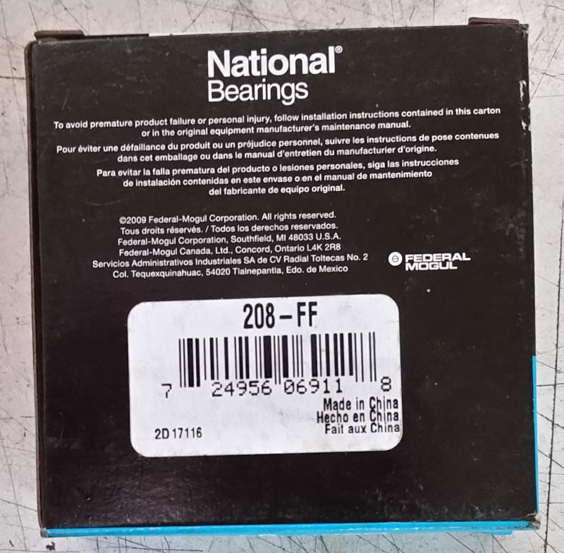

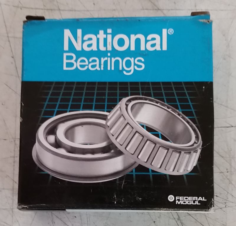

I needed to get rear axle bearings for my 2014 Tri-Glide last week. Could have gotten them from All Balls, but knew they were made in China.
So I ordered them from National Bearings, an American company I've gotten bearings from as long as 40+ years ago....
....and guess what...
Made in China.
They are installed now.
