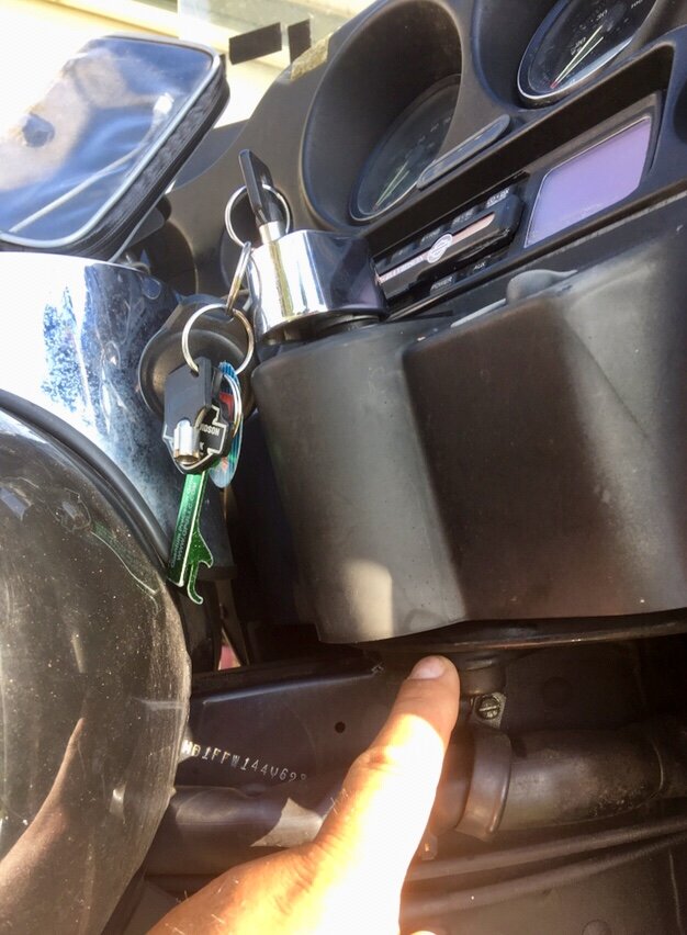

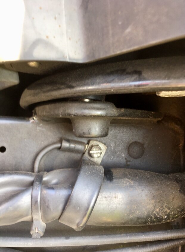

Probably want to spray from just under lock to where my finger is pointing. When you have lock turned to unlock position, you might be able to get knife or thin screwdriver in to pop up lock from stuck position. You can jus see flint of silver in closeup shot showing it in lowered position.
