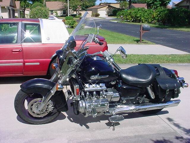

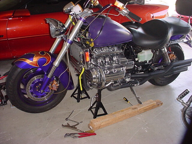

Just to show what can be done to a Valk with help from this forum.
Here's what I started with. And what I finished up with,
I bought a non running bike and rebuilt it back to 98% stock. I didn't refinish the wheels paint.
They stayed Purple.
I did it in 7 months, a lot of time and money.
Only to sell it at a big loss when I found I couldn't trike it the way I wanted to.
First pic the day I brought it home.
Second as sold.
Truth be told. I should have kept it.
