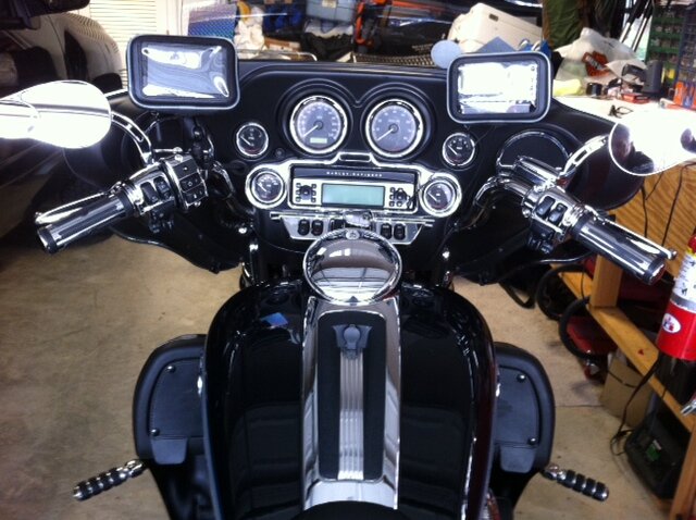

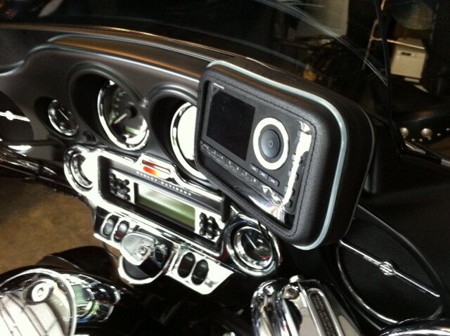

Dave, I used the same cables and wires that came with the XM. All you need is the power wire with cig. plug. I plugged it in line to my battery. The XM Accessory plug goes into your accessory plug on your HD radio. Antenna you can put almost any where. Used a Ram Mount for radio and GPS.
