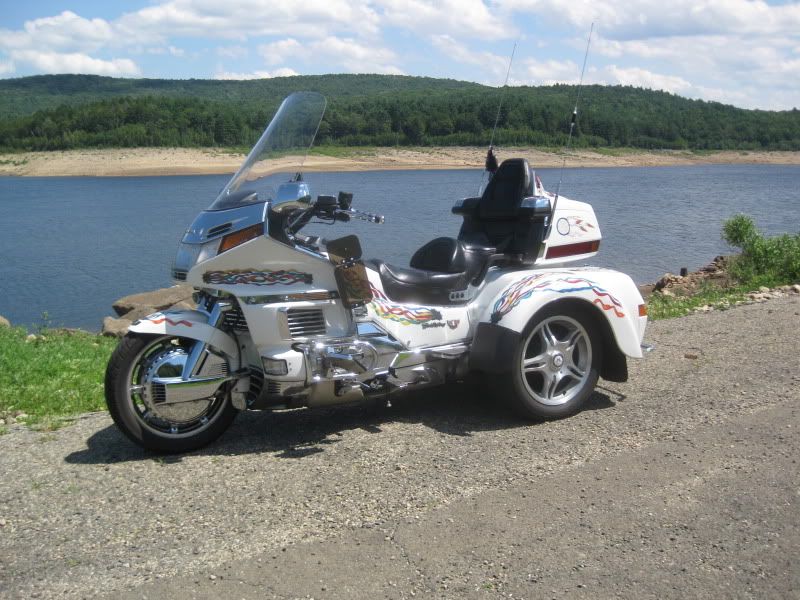

When it landed on the yellow line I said as soon as the traffic clears I run out and get it. Then bam bam bam. Then tears. You know what my side covers look like .
Close look at bottom front corner of cover you can see the bolt that is holding it on.

Barbara likes the picture of your bike and wants to know the general location of the countryside pictured in the background.
