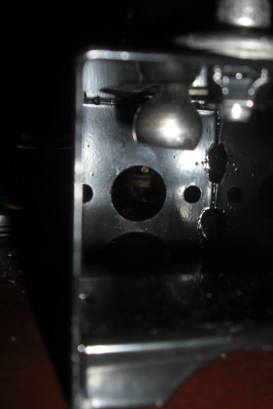

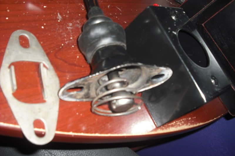

I searched around for pics to compare my shifter to others but could not find anything close up enough. Mine is like a half ball, flat on the bottom with a little bearing in it.
second pic is view from inside box. It just doesn't look long enough to me.
I don't have easy access to a complete shifter unit right now, but:
1. I did find enough to measure that from the bottom of the shifter housing to the bottom of the shifter ball (flat part) when seated is only about 1" (I say about because all mine are modified to lower that ball about 1/4" to make them 'short shifters' so I couldn't get an exact stock reading.
2. Other than a pin that was used on bent style shifters, the lower end of the VW shifters didn't change, so the one you bought should work.
3. You are installing the nylon bushing in the back of the shifter box, right?
4. When does the ball slip out of the socket, when moving side to side, or when moving forward to back, or both?
I tried also, and didn't find any good diagrams (Internet searches) showing the shifter mechanism.

Haven't had much time to mess with it, but today i assembled everything on the ground just see what it looked like lined up straight. The ball still just barely sits on the top of the socket. Its as if the shifter just isnt long enough. Id love to see a pic of one to get an idea of where i need to be, but i cant seem to find anything online.
I have mine apart right now. Will try to get you some pictures. as far as I know.... Or as far as I have read... My shifter is pretty radical. No joint, just a two and a half offset in the rod. Anyways.. will try and get you some pics

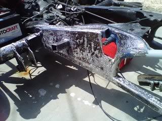

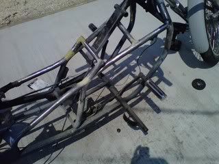

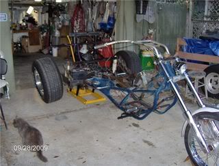

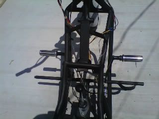

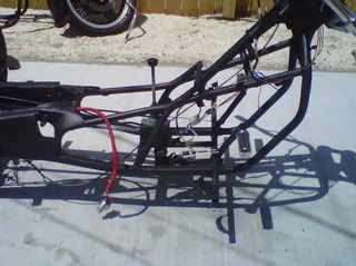

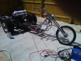

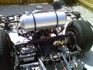

first two pics are is how looked when i got it. I got all new ignition and motor wiring, plus added a wire harness for lighting.
Had to clean up a lot of nasty welds and rust. Stripped it down to bare metal. Its now primed and painted, i used truck bed liner spray, had my doubts at first with the bedliner stuff, but it came out really damn good!
Also got rid of the old home made handle bars and got 14" chrome ape hangers.
Im not using the old gas tank or body... I got a nice aluminum tank as you can see.
Right now im working on a building a new body, it will only be on the front half.
Will post more pics when i can ;)
