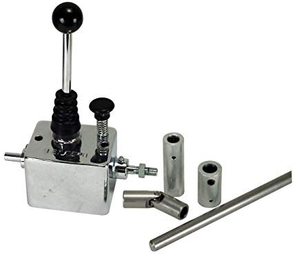

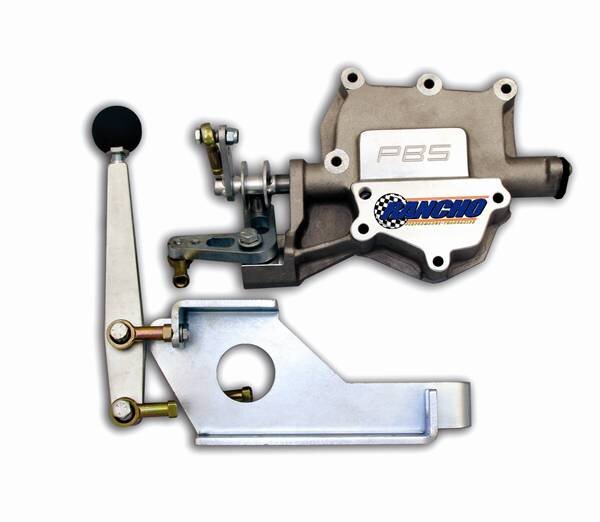

With a cable shifter you could put the stick lever anywhere you want to.
You can move a stock or standard type shifter a lot. As long as you can make the shift rod turn and go in and out. The more angle you put on that rod the harder it is to get it to work right. The dune buggy super shifter and universal joints work well, especially if you can not spend the money on a cable shift.
