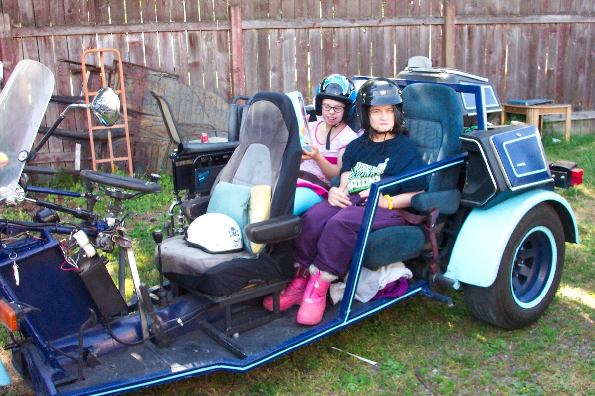

I'm building a VW powered Mid engine trike. I have the drivetrain 95% done. I'm in process on the frame. A pretty simple frame with a rear bench seat that should be big enough for 2-3 butts. Here's the question of the day-Do I put seat belts on the bench seat? I don't want my passengers to go flying if I have to panic stop. No, there are no roll bars/cage to protect if I flip. What do you think? Thanks!
Here's a pic of the style trike I'm putting together. This is NOT my trike.Attachment 24090
I would say it's your trike, your design, your build. Do it the way you think is best. Though I do believe something to keep your passengers within the confines of the trike would be a good thing.;)
How many of us trikers have seat belts for the butts that are perched behind us? I agree with Ozarkryder, your playground, your rules.
I understand that seatbelts have been deemed "DEADLY" by almost every triker riding today. The difference is most trikes have room for one passenger. That passenger CAN"T fly off even if they tried! On my trike I can seat three passengers on my bench seat. There is NOTHING to prevent those passengers from flying off in a true PANIC STOP! So?...
As above, something to keep folks on the rig is a good idea, and with a bench seat there isn't much to hang on to. I have seen seatbelts on trikes like the Renagade, Ecstasy and some homebuilts with bench seats.

maybe a lap bar like on a ride at the carnival ?

Guess I will go with the serious answer. I've actually given this some thought for my next trike. If I get bench seats, I would go with lap belts. My wife doesn't pay much attention until I have to make a really fast maneuver ...Then I get smacked in the head!
Seatbelts seem to be rare on trikes so I assume most people don't think they are necessary. The way I see it there are arguments both for and against. Say if you rear-ended a car, you and the passenger would not be launched into orbit which seems like a good thing. On the other hand if the trike went off the road and was tumbling down a hill you probably wouldn't want to be belted in. So I guess they are something that could save your life or kill you depending on the circumstances of the mishap.:Shrug:

First the obvious is one won't "go down" riding a trike.
Secondly the OP is talking about a bench seat behind him. That means, depending on the size of the seat, passengers will be ooutboard of the rider with nothing to hold them in place during a panic stop.
In this case, for the OP, seat belts is a YES!
Undoubtedly I will catch some flak from this, but the flow of this thread is based on seatbelts vs. no seatbelts on a trike with a seat that can hold "2-3 butts". To me the risk of a trike with that design is significant no matter seatbelts or not. Just the dynamics of that motorcycle lend risk upon risk, such as a high center of gravity (more weight on the top position of the cycle), more frontal exposure to passengers being 2-3 wide vs. 1 wide, increased weight to add to the forces that lend to instability in rollover dynamics. I do not mean to fault any of my brother or sister trikers if you choose to build that way, but as a seasoned trike designer, fabricator, and engineer I would always hold safety as the #1 criterion for any trike.
Basically, build a trike to hold the conventional two riders and keep all others safely back at home awaiting their turn to ride.
Truely, truely no offense meant, so please don't blaze me too badly. Remember I said you can build whatever you choose, but this subject has been opened on our forum and I think that I would be remise if I didn't speak up. :cxtv:
:Coffee:I'm not going to lamblast you at all, I would simply say that it is the builders and pilots responsibility to keep his passengers safe and do whatever is necessary to do so?
if you can't do that don't build the trike or don't put folks in harms way by taking unnecessary risks?:Shrug:
The difference between a good trike and a bad one depends entirely on the integrity of its builder.
