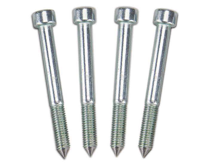

On our last trike, a 1995 GL1500 with a Motor Trike conversion, had lineup problems with the custom seat we had on it. The Phillips screwdriver idea helps to line up the seat and frame holes, and I ground down the seat bolt ends to a dull point to help the bolts feed into the frame holes. There are also seat bolts you can buy that way (pics below). Did the same on our current GL1800, also with a custom seat. It also seems after I get frustrated, walk away and take a break the darn thing lines up perfectly the first time when I come back to it.
