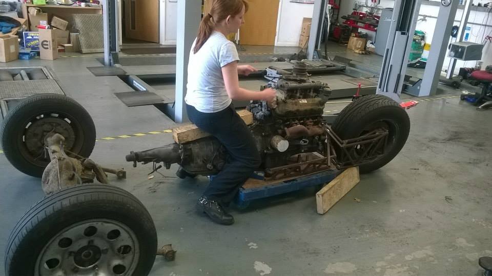

Hi all,
I am building a Ford cologne V6 trike from scratch and would like an opinion on a crazy idea i have had.
Would it be possible to run such a beast of an engine with no radiator. There would still be water but the hoses would just loop together. The theory is that as the engine is so exposed, it may not run too hot unless maybe it was in heavy traffic.
This is a picture from about 6 months ago but due to work, it hasn't changed much since then :(
Sorry, you must run a radiator. Recirculated water will just get hotter and hotter. You gotta cool it down before pumping it back in. Your pretty 'lil ford has no cooling fins to disapate heat..

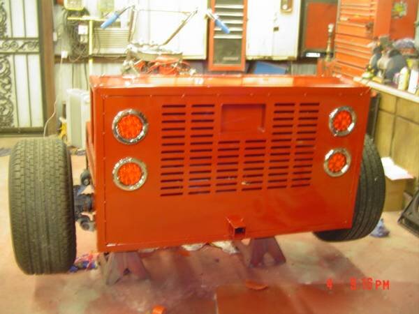

I built mine with the radiator in back and used a in line electric water pump , electric fans on radiator and pumped the coolant to the front. I used homemade adapters to run it in and out of engine . Its a v6 4.3 and ran all summer in nh with no overheating problems at all. In fact engine is completely coverd and i sit on the engine. lol. Its an ugly bitch but its legally registered and inspected in NH

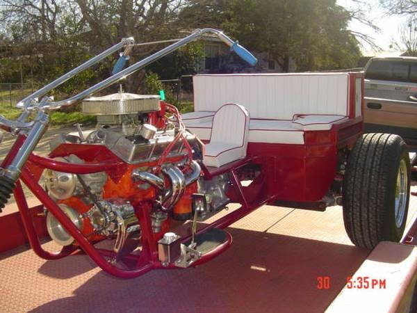

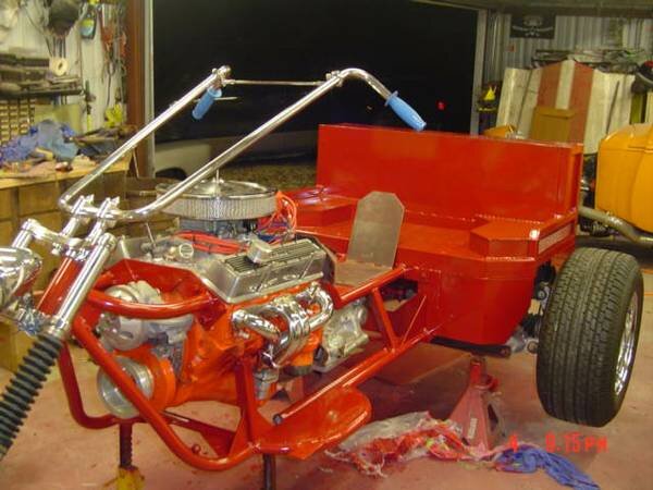

Heres a pic of my 425hp Chevy powered trike, ran custom hose from Stuart hose company to the rear alum radiator, electric fans, trike chev front rite upl shot.jpgtrike chev front right.jpgit has a Lincoln independent rear end and auto trans, for sale-13,500 :cool:
