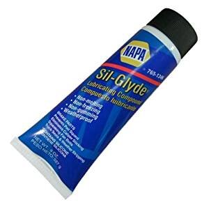

Could I put some of that on the rubber grommets that hold the side covers on to make it easier to check the air shocks or would it make them too easy that they wouldn't stay on?

YES, IT is a very good lube for ALL rubber, I use it on all my power windows and heater hoses. When I taught break class it was the first item up on display, We had a contract with Napa at the time, it is available every where now

I don't know about your Freewheeler side covers but I do know Honda GL1800s have a habit of loosing theirs if the grommets are lubricated. I would be VERY CAREFUL putting anything on those grommets. :xszpv: :xszpv:
Sil Glide for bushings
That's fine but are they really "bushings" - ie: rubber bearings. The front suspension on older Brit cars used "Hydrolastic" (IIRC) "bushings". These were intended to flex not slip. Unlike a bearing the shaft wasn't supposed to slip inside the bushing. Lubing them caused the shaft to slip, ruining the dampening effect and quickly wearing out the "bushings". I have no idea what H-D uses on the swing are but be sure b4 you lube. Does H-D recommend lubing them??

Good Point. Could be similar to a torsion axle... HUMMMMM????
This lube is NOT a fix all, None are However u use it is up to u, Your Ride U Decide JMO
