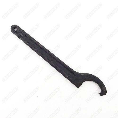

Question, Interstate riding, smooth as silk, some mountain twisties w/some rough roads, or even straight and true roads w/some rough pavement, rides like a logging truck as it rolls over even the slightest of irregular road. The installer said he had set the suspension for two up riding. I have not been up under there to examine where the spanner nut is set, but anyone have some input on this setting. I have the psi on the rear tires at 26 as recommended by the installer, and front at 41 psi. Maybe this tightly sprung ride this is the way it is supposed to be, and if so, I'm good with that, I'm not officially grumbling about it. By the way, does not have the adjustable pre-load.
I have the exact same trike as you regarding bike and conversion year and I'd also be interested in hearing about how to adjust the suspension just for information sake.
As I can never get under my trike as well, my installer and friend/mechanic at the dealer also verified that my suspension is set at the softest setting. I rarely ride two-up but have always had my rear tires set at 20 psi and just recently brought my front tire down to 38 psi from 41. I can honestly say that I haven't experienced any rough ride conditions regardless of the road surfaces.
Thanks Rich, I think there must be something in the suspension setting, but I'm getting a bit long in tooth to get up under there, so I suppose I'll have to go back to Daytona have the installer check it, not something I want to do, it's almost a two hour trip. If I could only get him on the phone, but I know it's difficult to pull him off the job, and I'm not so sure he'd remember anyway. I'm hoping that RS will see the post a post a response.
Hiya Bill,
From what I remember my installer telling me, there's just a simple type of ratchet on the suspension that you place a special spanner wrench (which Roadsmith provides) to adjust the setting. Now I know that mine has never been changed (softest setting) and the very few times I had a passenger on board, my present settings seemed perfect including the 20 psi in the rear tires. And in all honesty, I really could never tell the difference in the ride with, or without a passenger. I hope this helps.
Thanks again Rich. I'm two up in Sevierville TN now, heading to the Smoky Mtn Ride In on Wednesday. I have the spanner wrench, so I need to get up under there when I get home plus review the setting procedure, if it's the softest setting, then do nothing. Somehow I think it is not softest, I'll also be trying the 20 lbs psi.

Thanks Fab, of the three options, I have the standard, that would be the old manual spanner wrench set. the pre-load was a $300 option, which I didn't get, financial limitations you know. Having reviewed all the paperwork information from Roadsmith, I see nothing on "how to" for manual suspension adjustment, I have an e-mail out to Roadsmith on how this should be accomplished, so far no response. So, wishing now I had somehow found an extra $300 for the pre-load. I didn't realize at the time it would be so important, nor was it explained to me at time of purchase. Or, let me put it this way, if it was explained, I don't recall. I do recall the Accuride, but I sure couldn't afford that luxury.

Right Rich, I've seen your posts on the the suspension, and know that we have the same set up. My question is specifically, when I get up under there and look, it's a tight area, and looking at what "I think" is the spanner adjustment, how do I know what is the softest adjustment. I don't want to be screwing around under there adjusting something and not know exactly what I'm doing.
I understand your concern. As I can't get under my trike either, I had originally requested the installer (KD Cycle) to set the suspension at it's softest setting and then later asked my friend/mechanic at the Honda dealership I use to verify it was at that setting. Wish I had a lift at home to tinker with the trike and cars,,,. :Shrug: My days of laying on the ground under vehicles up on jacks are over! :(
Rich, I understand your concern and feel your pain. I ain't young anymore, I'll never see 75 again, getting under that beast is not a good feeling, getting up is another problem. Absent any information from Roadsmith, I might just trip over to Fun Bike Center, Lakeland, a 30 min trip and ask those guys to look at the setting. Those folks are not cheap, and at $80 per hour, my pocket will suffer just for them to look. That does not make me a happy camper either. Maybe I will run my rear tires at a lower pressure as you are doing. I think it was 20 psi or something in that range. My only concern, is on hot days, on the long rides, will that cause the tires to overheat? I always think about Murphy's Law.

I have an HT kit on my 1500. There are twin shocks made by Progressive Suspension with 5 preload settings (normal for Progressive shocks). When I picked the bike up, the preload was set on lightest setting. I have since cranked it up to stiffest and it handles and ride much better. In addition, there is an optional torsion bar of larger diameter that improves the ride a lot according to some folks who are in the know. Last, I think Roadsmith offers a system called "AccuRide" which is essentially a shock upgrade that offers Progressive Air Shocks instead of the coil spring shocks. Cranking up air pressure will essentially add preload. I have never been a fan of air shocks as air doesn't compress and can make a bike ride harshly unless you stay on top of the amount of air in the shocks... I prefer coil springs. Preload on coil spring shocks is best done with a tool that looks like a half C with a handle... You just reach around the section with notches where the tool fits into a notch and turn the shock body over the preload setting you want. Adding preload helped the ride of my trike a whole bunch and it rides a zillion times better than on the softest setting. A shock preload adjustment tool was part of almost all 70s vintage bike tool kits. You can find preload tools on eBay... some cost $60 and some $6 and all work pretty much the same and will work on the Progressive shocks under a Roadsmith trike.
Thanks George, good reply. I have the manual that requires the spanner, and I have the spanner. I can see up under where the spanner would work, not under or over the coil, but a separate shock unit. So it appears that shock is on the last setting, is that soft of stiff?
Being that you find the ride so harsh, I'd guess it's on the hardest setting. Try reversing the disk to the last setting in the opposite direction and try a ride then.
You don't have to guess where the preload is set. There are notches on the preload part of the shock. The lowest notch (toward ground) is the softest preload. As you turn the shock body with the preload tool, it goes to one notch step which essentially compresses the spring a bit. This adds preload and stiffens the shock. Once you get to the stiffest setting where the spring is compressed as much as the adjustment allows, the next step is back to softest. Since all it takes is a crank, move it to the middle position and see what affect this has on the ride for you and your passenger. Make sure you do both sides. If set on the softest preload, I am pretty sure the "harsh" ride will mitigate. If ride improves, it is time to experiment by adjusting further.
