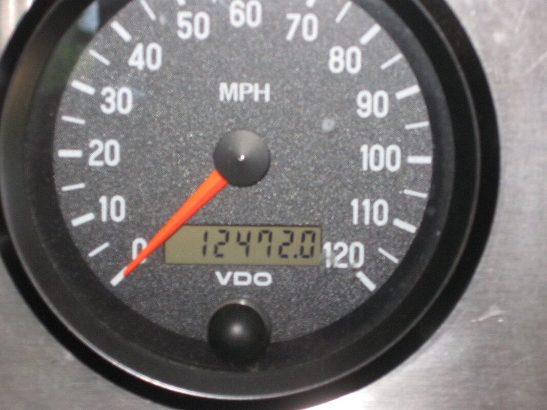

I'm guessing that the odometer isn't visible. The Roadhawk has a LCD odometer/tripmeter display on an analog speedometer. Here is a picture of the speedo on the 2007 Roadhawk we had: IMG_0961.JPGThe odometer may not be getting power so it's not visible to inspectors. If the speedometer portion works there may by a problem with the wiring up to the unit or something internal to the gauge itself. A VDO speedometer is about $180 new, sometimes a bit less on ebay. Some used ones can be had for much less, with either analog or LCD odometer versions. The analog versions don't need power for the odometer, just for the gauge light. If you order a new one be aware they come in 3 1/8" and 3 3/8" and they look exactly alike.
