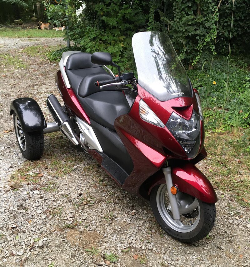

I am new to trikes and I keep hearing you guys take about mounting tires in reverse. Just what does that mean, I try ed to do a search on it but never get anywhere doing a search. [ old fool on the computer ] Please tell me what it means.
Thanks in advance.
