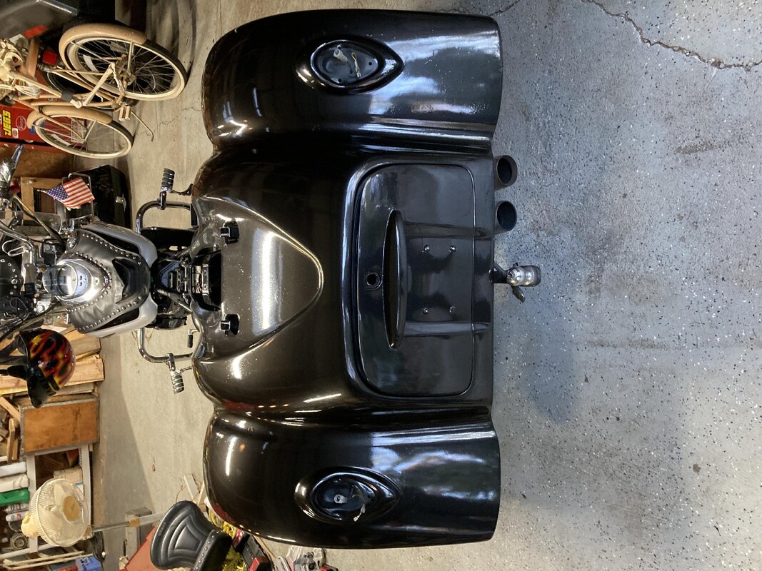

Nice job!! Did you use the spray?
Thank you Sir! No spray, just used the brush kit and a hair dryer to gently speed drying, some 1000 grit and polish. Most of it was in the kit, primer, base, tint, clear top coat, test strips, some fine sand paper, instructions. Some colors use both base coat and tint, some just have the color in one step. That chip was where some careless fellow threw a door open, looked at it and walked away, I first smoothed the edges of the crater like chip that went into fiberglass, then filled with primer and etc. The fill layers took time waiting to dry. I had a few other places I retouched too. I found the fellow in the restaurant, he was a few bricks shy of a load I think, his dad offered me $50. I just let it go.

How many chips, how big?
Before and after using kit from https://touchupdirect.com/

WOW! We get a similar effect from 'love bugs' not getting cleaned off promptly. How did you get so many chips?
