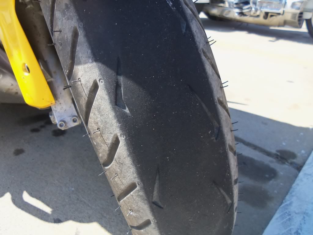

Wow Larry ( river rat). You arre hard on tires. Is this a rear bias ply you have up front. Most people get in the mid 20,000 range. If you were running the OEM up front I bet you would be lucky to get 6 or 7,000 or of it..
yes, I have the rear bias ply tire up front and run 41 psi in them. I wish I could get mid 20's out of a tire but it just hasn't happened for me.
the OEM front tire at 8,000 miles
