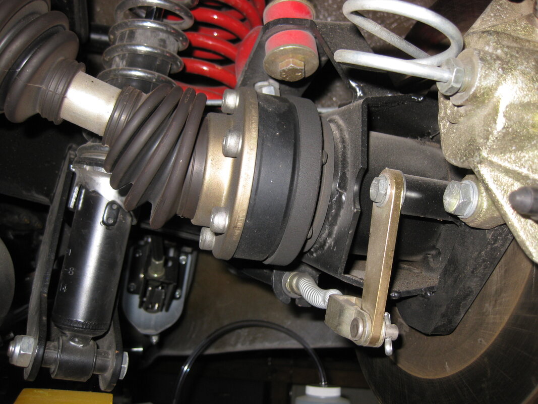

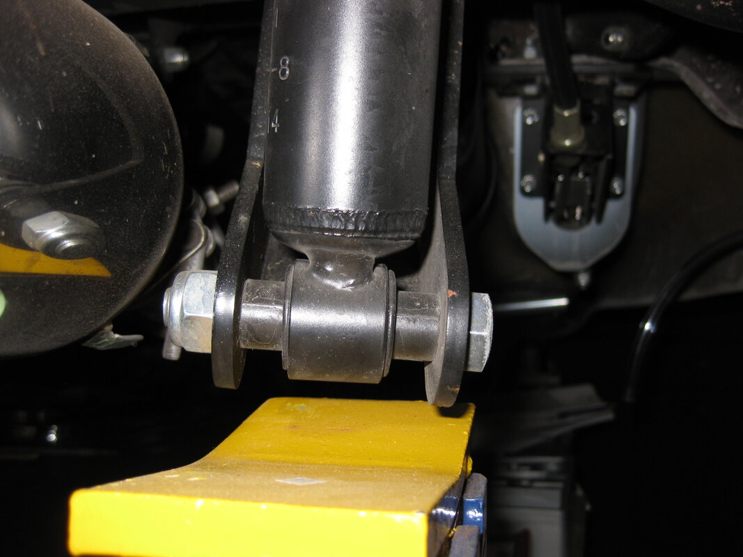

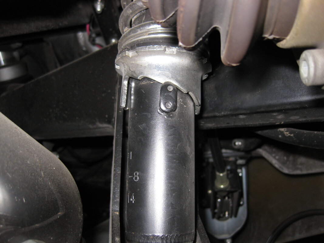

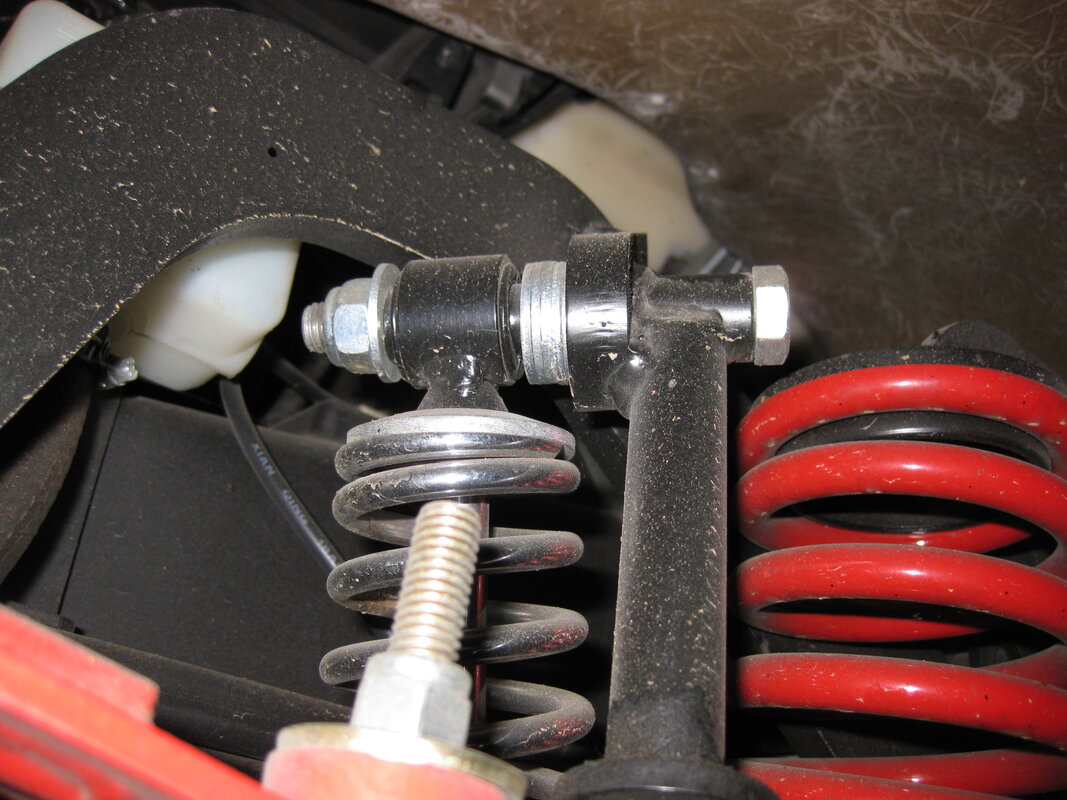

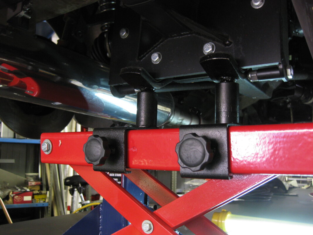

Watch the video close again and look at the photo above the video, that big RED Spring that compress's is attached to the Sway Bar frame so when the spring compresses it stiffen's the suspension against the sway bar. The shocks are totally separate and are a manually adjustable item.... that is used primary for body roll in turns. They adjust by setting the preload on the dash in the video to - 0 / lift the trike at the rear-end pumpkin to allow the wheels to hang free / stabalize at frame with jack stands to allow removal of wheels / see photos of shocks to see where they are set, most come from the factory set at the bottom and some installers never adjust them which is generally to loose and allows body roll, my Progressives have 5 settings and mine is at 3 but can be made even stiffer by turning the shock body while it has not weight on it going to 5 , but I also have the HD Sway bar installed and the 3rd position works for us two up and the pre-load set at 10 for the trailer. So it depends what you are wanting to adjust. Re assemble and test ride....
1. Body Roll - Adjust the Progressive Coil-over Shocks
2. Weight Carrying or Trailer - Pre-Load
3. Ride Quality - Rear Tire Pressure & Pre-Load
Hope that helps...
