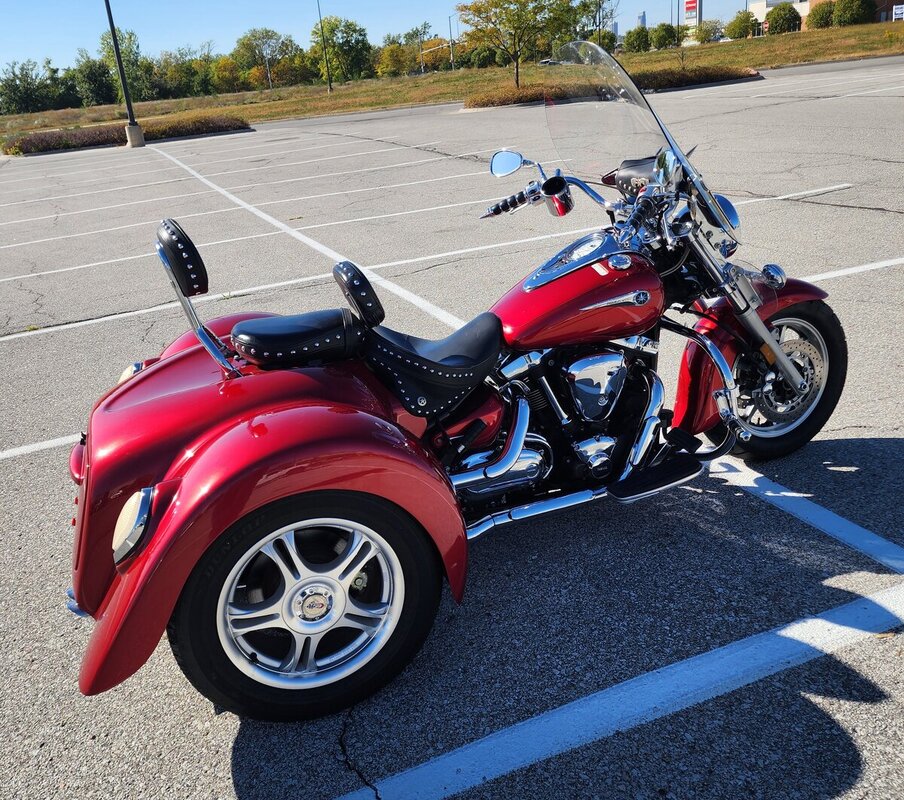

Just got this a few days ago, and I'm new to trikes. How do I know if it has already been raked? I am not familiar with the Yamaha Road Stars, and I can't really tell by looking. Maybe someone here can?
Also, I get a lot of wobble on bumps. Is there a dampener made for this make/model?
Nice looking trike. While I can't be sure, based on the distance from the front fender to the frame, it does look like it had been raked.
How difficult it is to steer?
I know it’s different bikes, but I noticed the “wobble” in mine right after I installed the RoadSmith and Rake kit on my Harley Ultra. I live down 5 miles of gravel road before I get to the highway and it was quite pronounced.

If there is any wobble whatsoever in a trike conversion I build, it does not leave my shop and I have never once reinstalled a steering dampener on any conversion. If there is wobble, the first place to look is at the steering stem bearing torque preload. Loosen the lower fork tube pinch bolts, retorque the rake preload until you feel a noticeable resistance to turning the forks. By that I mean there is some resistance, not a lot, but it is there. I set it first by ft lbs of torque preload to 35 ft lbs, but sometimes I go up to 40 ft lbs. It is as much by feel ad a number on the torques wrench.

I want to add more pertinent information to this thread, specifically to address front end "wobble" and the factors that contribute to it. There are a number of contributing factors, the most common one being improper steering stem torque preload. To be clear this is the first thing to check, and adjust and is the most common cure, but it is not the only factor that can contribute to front end wobble, so in no particular order here are the other more common contributors:
1) Out of balance front and or rear wheels/tires.
2) Out of round front and or rear tires.
2) Over or under inflated front or rear tires. (I see this a LOT on trikes that come in to my shop for service.
3) Patches of terrible road surface conditions. (obviously)
The steering and suspension feedback dynamics of a vehicle riding on a 3 contact point configuration (trikes) VS a 2 contact point configuration (motorcycles) or a 4 contact point configuration (automobiles) is inherently different in how each reacts to poor road surfaces. By their design, trikes will naturally react more than motorcycles or autos and that feedback is instantly transferred to a trike's operator via the handlebars and can be very unnerving. That said, any or all of these can contribute to headshake or wobble, so all need to be addressed.
