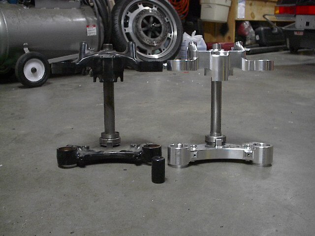

Look at triple tree as well. Honda OEM is black while Champion EZSteer is billet aluminum. Mine has Champion EZsteer 6 degree kit I installed 2004.

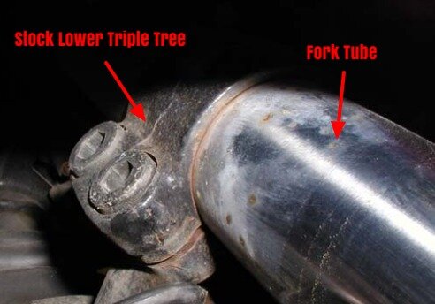

You can look up above the front wheel, under the fairing at the lower triple tree from under the front of the trike and if it is black cast metal like this, it is the stock trees and not raked. If it is unpainted machined aluminum, it is aftermarket and raked.
