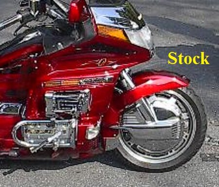

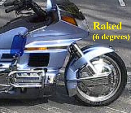

I thought same, those fork tubes do look very steep, like OEM. Front fender/tire is tucked way back into cowl. Don't see much space between lower cowl and front tire. Five (5) degrees would show more space, surely the PO didn't pay for ... and then not receive the 5 degree setup? Rare I'm sure, but it could be?Just as an example, below pics: Red is my trike, a 1500 with stockfront end. Blue is a friends trike, also a 1500 in same parking lot in 2004, but his had a 6 degree EZSteer kit. You can see what a rake kit does. Compare tire / fender to lower cowl. This was back in 2004 before I ordered & added a 6 degree EZSteer kit to mine, after riding his in that parking lot.
