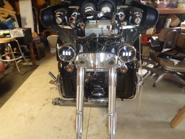

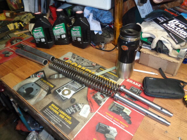

I did the upgrade month or so ago and let me tell you no more nose dives no more washing out on the down hill curves and the handling is so smooth. Old Shiney must think it is a Sports Trike now. LOL...
