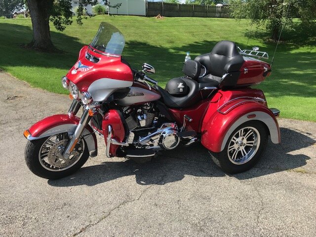

I sure do hope the vent works, I got a lot of time invested in this thing. I bought my first new Harley in 1970 and this is the first one thats had a problem I didn't cause myself.
