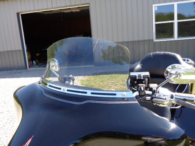

2+2 sweepers
Can you tell me why you picked the "wide sweepers" over the "narrow" sweepers? i am 5'6" with short arms and thought that the narrow bars would be better because of my size. You are 5'10". but with short arms also. Would the height be the reason or am i missing something here.?:Shrug:
I had the wide sweepers on my roadglide and just like the way they feel. I feel by having them wide , gives my arms more turning force since now I have to turn the front wheel rather than counter steering in a turn. im thinking I can always set them closer to me if I need too. on a 2011, it pretty simple. remove the key switch, remove lower fairing below the radio, 2 screws. and you can get to the lower clamp allen head screws with a ball joint allen wrench. loosen them, move bars and tighten. also stock handle bars were just to low and hand position was uncomfortable in a tight turn even with the bars has far forward has they can go.
Different angle on grips
I chose them for the lesser grip angle, narrow ones are I believe very close to OEM. The wide 2+2 Sweepers have worked out really great for me, they really helped relieve the pain in my wrists and shoulders Handle bar fit is a individual thing. ThumbUp ride safely fearless 5'8" short arms

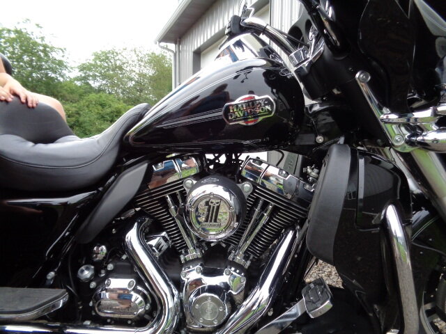

very nice!
nice looking trike! you mentioned that you lifted the tank. what was the benefit other than looking pretty sharp.were to I get a kit to do this?
very nice!

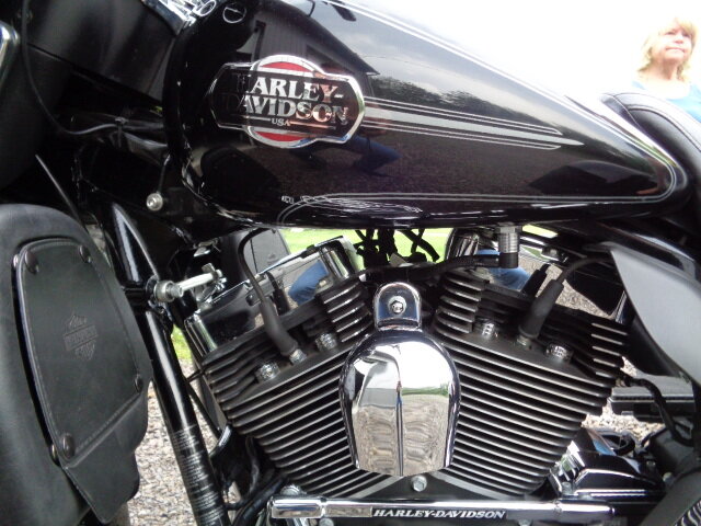

Tanks lifts push more air over the engine for cooling. Less air comes over the top of the tank, and for some this reduces buffeting. It also makes it easier to clean the rocker covers.
You can see more pics and info on a Tank Lift Kit at this LINK
Tank lift stopped Glasses dance
For me it stopped my glasses dancing on my face till about 80 mph, also cools motor better forcing air across it. So it is a win win for ole shiney and myself. Plus it does look really good easier to clean rocker covers.ThumbUp ride safely fearless
