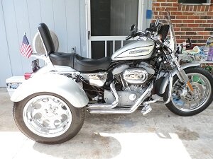

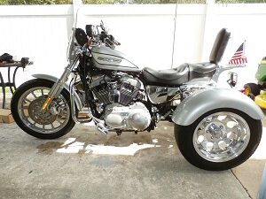

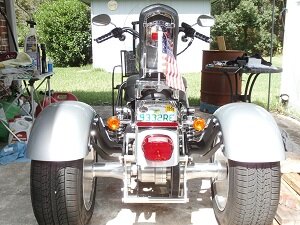

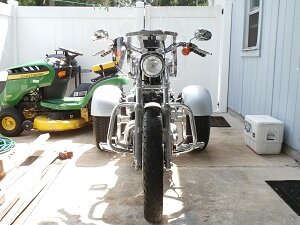

Here are some pics of my newly converted 04 Sportster 1200 Roadster to a Frankenstein Trike.Attachment 39810Attachment 39811Attachment 39812Attachment 39813[/QUOTE

Thanks. No engine mods. Rides good.
Nice. Minimalist. I like it. ThumbUp
One question -- why keep the bike fender in the center? I see that on a lot of conversions. I don't know why it's done.
Well in this case, with a Frankenstein conversion the original bike fender contains the rear lights (tail, brake and turn signals). Not to mention several modifications would have to be made for housing the seat.
Great looking trike! We have two 1200 Sportsters with Champion conversions... it was a hard decision between Champion and Frankenstein, they are both great kits.
Did you do a rake kit on the front? In my case, I rode it briefly with just the standard front end and it did not handle well. Once I installed a 5 degree rake kit on the front it now handles like it's on rails.
Yeah, I did 4 degree rake. Came withe the kit I bought. Rides very good.
