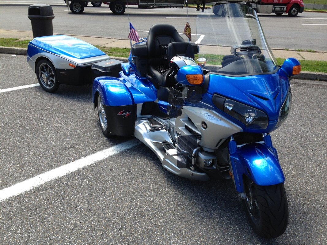

Using all of the various Baker Wings is very effective! Changing them around to correct the air flow is easy. I too have the Hannigan Gen II conversion and the trike wings help. Before I installed them, I noticed the turbulence increase on my first ride after it was triked (600 miles from the factory to back home). When my wife got to ride on the back, she commented on the increased turbulence. First chance, installed them and they do make a difference. Make sure you get the trike wings and not the smaller lowers.

Are yo still able to use foot pegs on engine guard with the lower wings ?
Nice looking trike by the way :)
Hwy pegs
When they installed the floorboards at Hannigans, they removed my Kuryakyn ergo pegs. They will not fit with Hannigans floorboards.
That being said the trike wings mount on the vertical part of the engine guards & the ergo pegs mounted on the horizontal part of the engine guards. Yes they both normally fit.
What I had to do was install a set of Rivco highway pegs that mount to the valve covers. Every change you make always causes compromises!

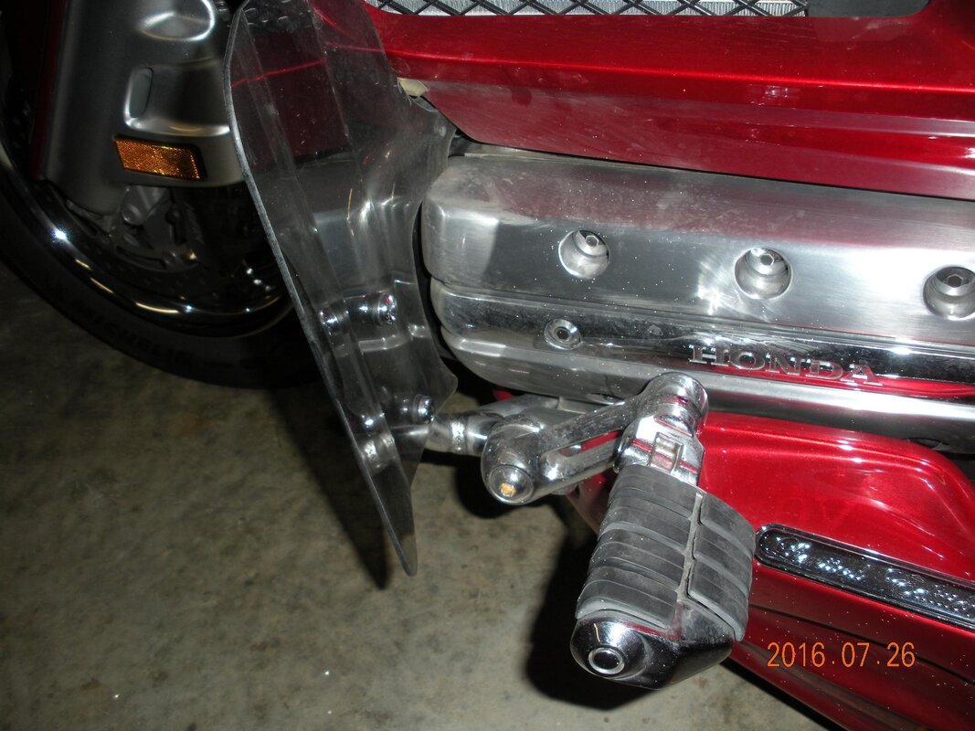

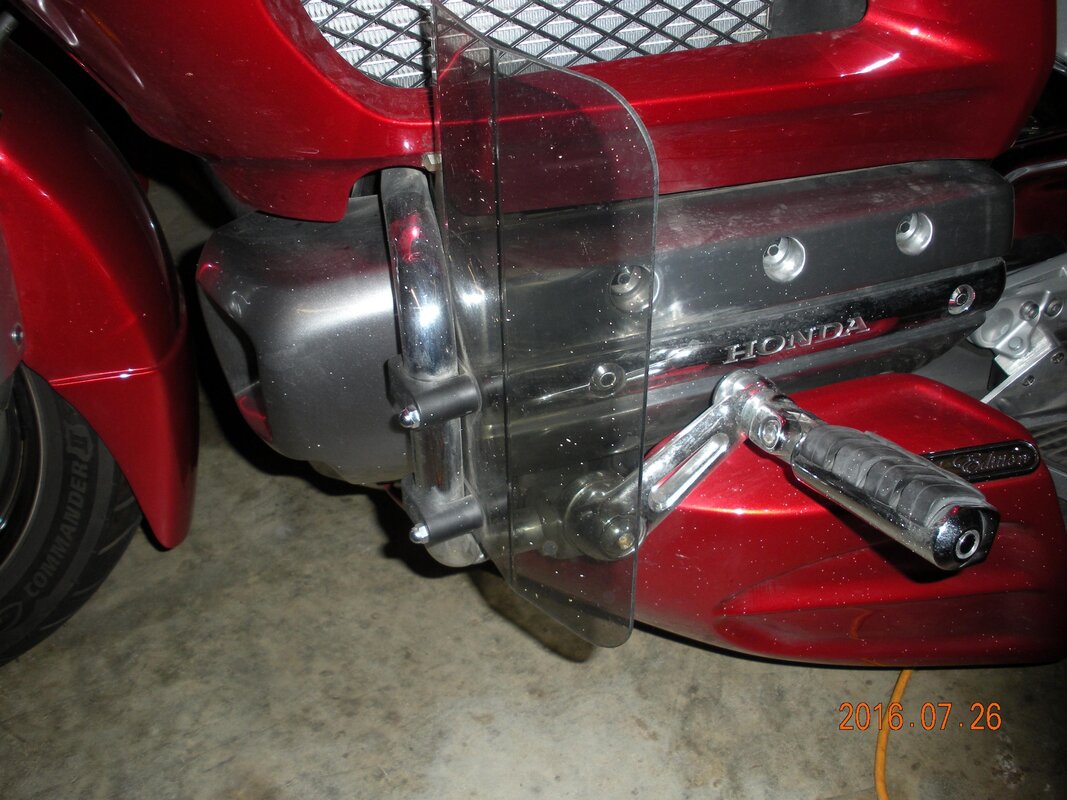

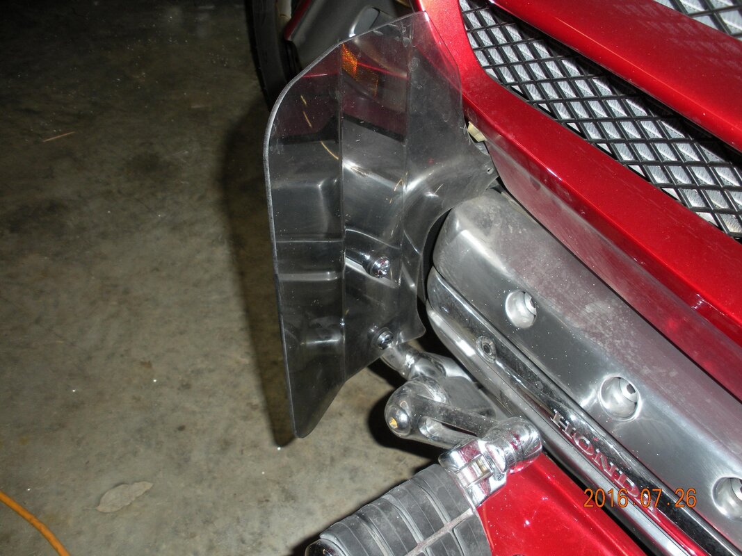

I have a 2014 Wing with Gen II Hannigan kit & have the Kury Ergo II pegs with 4" arms but I also tried the Mini and 6" arms. Due to my leg length the 4" were best for me. Mine are mounted right in front of the aqua shields on the horizontal bar of the engine guard. Very close but they do fit. I used the same Ergo II peg on my 2008 Hannigan Gen I but with the mini arms. There was more room to mount them on the 2008. You can see a pic of the 2014 in my Sig Pic on the GL1800 Riders Forum. Hope this helps. Ride Safe. Doc ThumbUp
Doc, I've got the same set up with the same problem but I've tried the Trike Wings and they do not fit over those arms unless I cut so much out I feat they would weaken them too much. Got a close up pic?
I see where you have them. But I have the 6 inch bars mounted vertically since it was the only way I could do it with the ground effects. Big difference.. Thanks though
