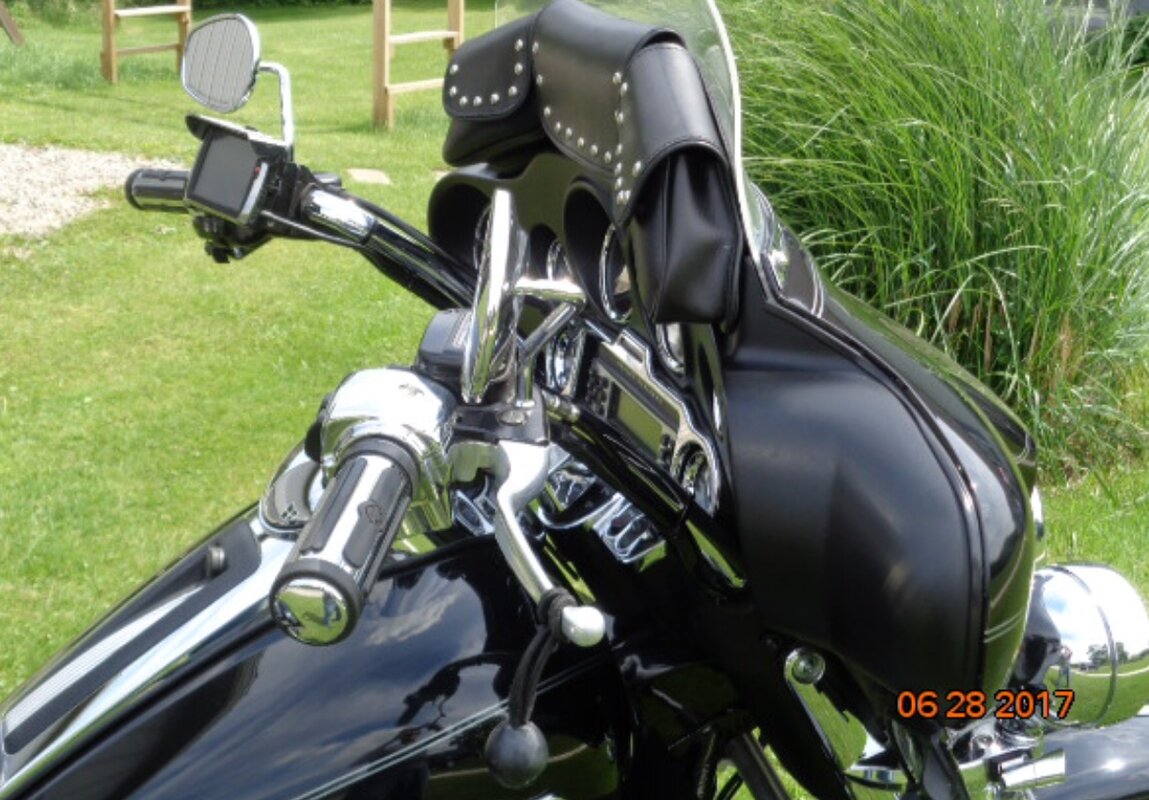

Loosen the nut and lengthen the adjuster # 29, it should hold @ 3-4 clicks
Simple, inexpensive, & you won’t forget to release it. Not my pic or trike btw.
Heh that's old shiney and yes it works very well. I have the cables adjusted but now I need new lining and most likely rotors this winter. I have shared close to Ten with others who had no parking brake. no problem using the pic. travel safe Fred
