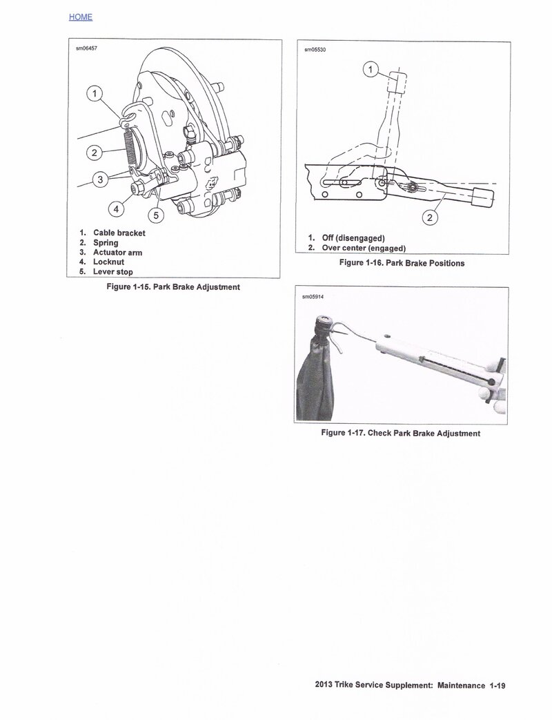

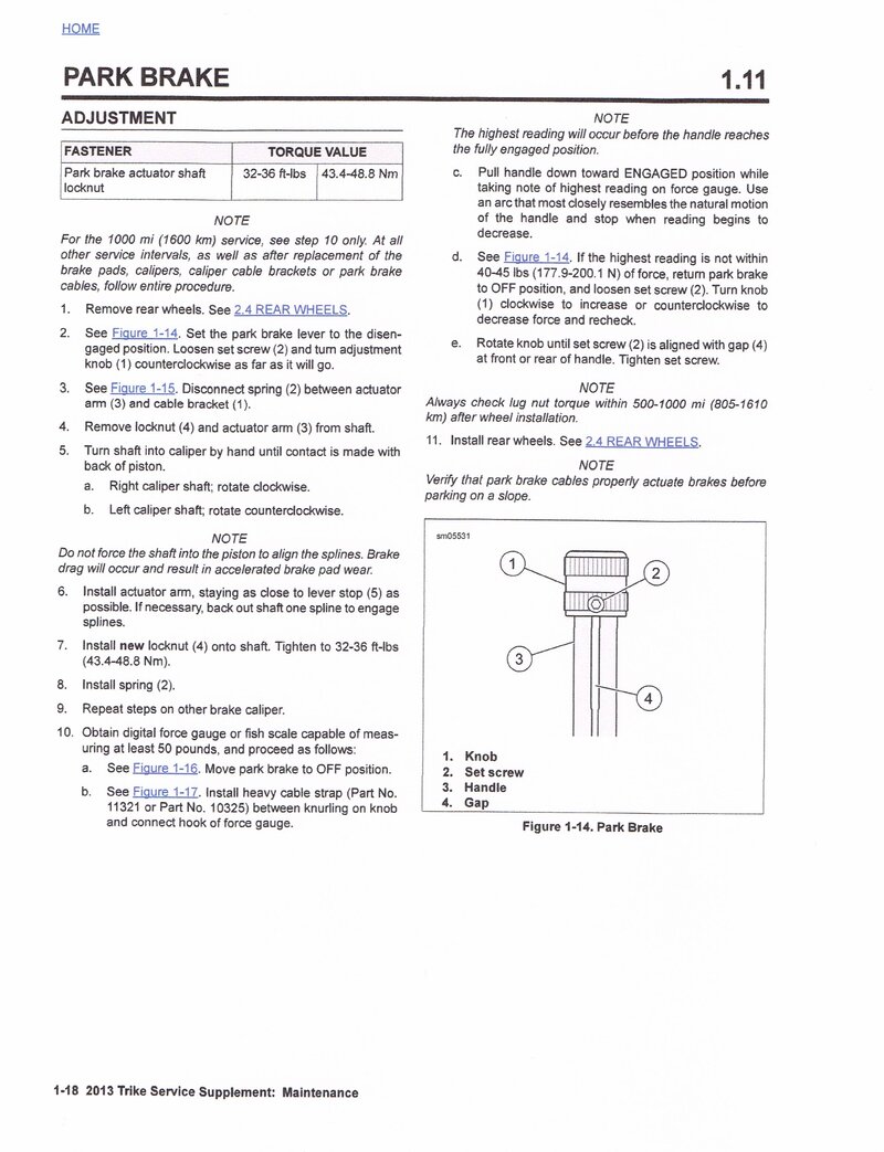

For those of you with a service manual, I just replaced the rear brake pads on my 2013 TriGlide. I need to know the proper method for adjusting the park brake arms on the calipers. In one spot with the arms fully released (against the stops) there seems to be quite a bit of drag on the rotors and when applied is stopped very solid. One notch looser and there doesn't have much drag on the rotors while released and no holding power when applied. I haven't messed with the adjustment on the handle to see if I can get more holding power when engaged. Thanks in advance.

With my 11 Tri, If i want to adjust the park brake i just do it with the knob in the handle... Loosen the small Allen set screw and turn the knob, To where it ''JUST'' holds the trike from rolling, Too tight and it will ware the brake pads quick, Too loose and it won't hold ..Its a balancing act, And needs to be readjusted often, That said i never use my park brake.. I park in first gear...ThumbUp
