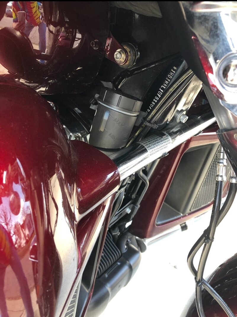

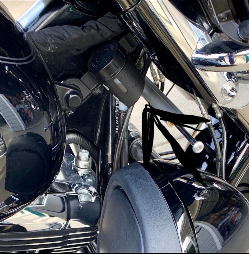

Question for those that have installed Papa Zook's TriGlide Rake Kit. The instructions says that the rear brake reservoir will have to be relocated. When turning sharply to the right the handlebars presses against the reservoir. My mechanic relocated mine under the outer fairing which I am not real comfortable with since the outer fairing will need to be removed to add/check the fluid level. Just curious where others relocated the reservoir?

As for the reservoir relocation, it is an easy job and no, the brake lines do not have to be altered at all. The top picture above is Scott's 2015 Red TG (Consitter) that he just raked with one of my kits and maybe he will chime in and add his 2 cents. I think he is loving it. Actually I know he is loving it by all the texts and phone calls...;) You there Scott?

Awesome. Thanks for the information/pictures. I guess it is held on with sticky-back tape?
I'll have my mechanic relocate to that site on my next visit.
From Scott's pic, it looks like his mechanic used a short piece of thin metal and drilled a hole in each end to form a bracket or maybe thats the stock bracket cut down. He secured each end with a black cable tie. The left side is secured to the main harness loom which is secured to the frame and the right side is secured to the clutch and throttle cables which are secured to the frame down tube. Plenty stable and secure and a good, easy solution.
Actually, the relocation makes it easier to add or change your brake fluid without spilling or overfilling it and sits much more level than the original factory location. Lowes and Home Depot have sticks of pre-punched thin metal bracket stock that you can buy and cut to length if you need a bracket. They are silver, but you can spray paint them black so they blend in. I keep several sticks of different sizes at my shop just for jobs like this.

Could you explain how you attached the reservoir to the frame when you relocated it? Did you cut down the oem bracket, use sticky tape or zip ties, etc?

It’s a 15. And I really don’t know, because my mechanic is the one that did it. From the pic, it looks like he attached the reservoir to a piece of slotted metal that’s zip tied to sthe frame.
