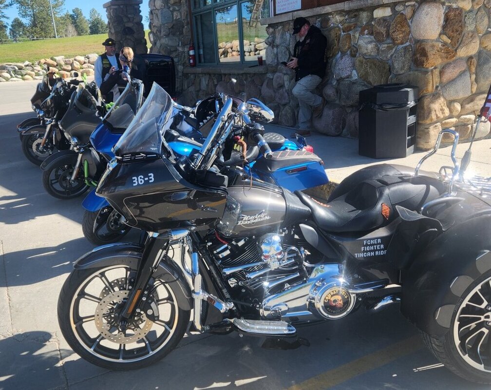

Papa Zook Rake Kit on my RG3
Thank you Gary, I'm glad you like it!
I HAD the rake done a couple yrs ago after shoulder surgery. On the way to Zook's,
I could only do a bit over 200-250 miles at a time ... when we left Zook's I was doing 400 miles at a time.. Thanks again Randy.. by far the BEST upgrade for me.
