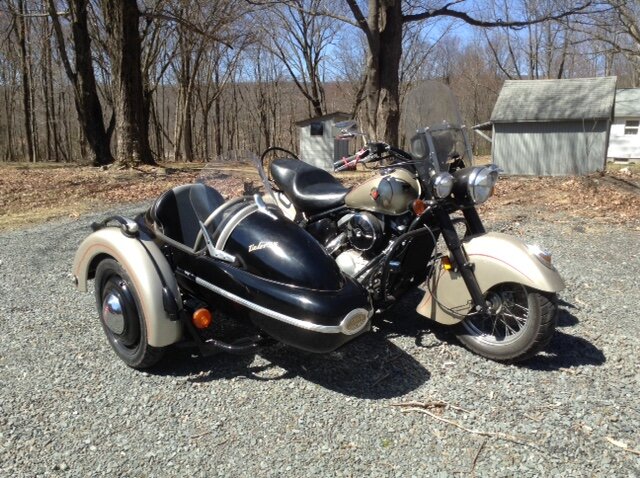

You need to call someone like DMC or someone that manufacturers sidecars. You need bike specific mounts. If they have them it should basically just bolt on. I just installed this sidecar. Basically everything is homemade. But it would easily transfer to another bike same model and year. I'd call around if i were you. Get the straight scoopimage.jpegj
