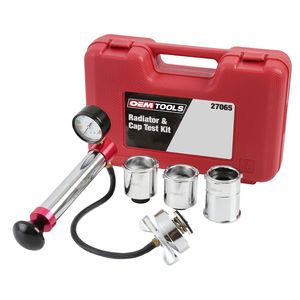

The best way to check leaks I have found is using a pressure test kit similar to this one, ALWAYS check your radiator cap first ( be careful when testing hot fluid)
You can some times rent this equipment from Auto Zone and others

Thanks, I'll check for a pressure tester at the local auto parts place. However, my main question is why the overflow tank is not sucked dry by the radiator.
