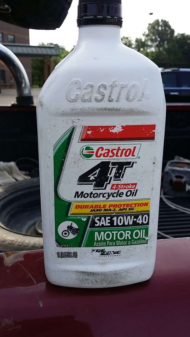

I use Castrol Mt1 motorcycle oil from orielies auto.
Now if you have a stockish engine with stockish cam and springs you can probably get away with any oil. But big cams and dual springs probably not.*
Sorry guys. ....
I mis spoke myself there.
The motorcycle oil is not Mt1!!!!
It is 4t.
Carol has a Dino version.
Yes the vr1 is a synthetic or a blend.

I would much prefer the vr1 over the 4t. Not because of the zddp but I don't want/need the clutch additives.*
