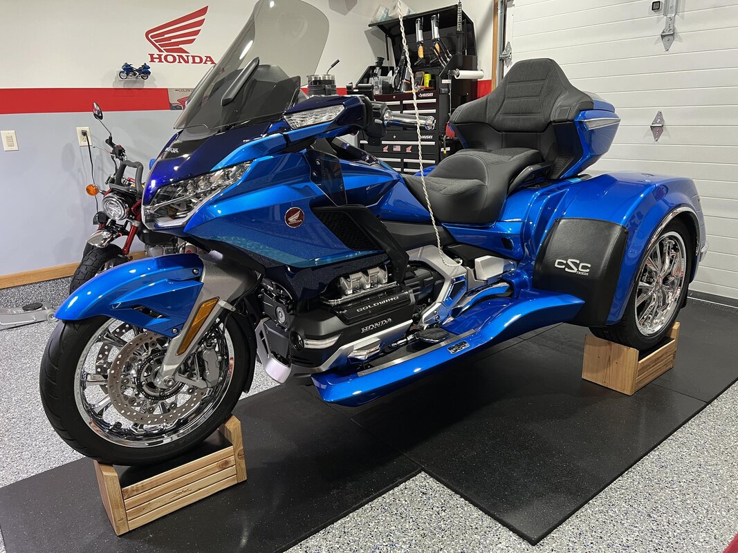

I cut a 4X4 board three times at 14' long......................... I then jack up the rear of my TRIKE and place a 4x4 under each wheel, Then jack up the front wheel and place a 4x4 under the front wheel........ This raises up your bike 4inches , high enough to place a pan under the engine for oil changes...........
Warning: BESURE TO PUT A TIE AROUND YOUR FRONT BRAKE TO HOLD YOUR BRAKE ON, AND PUT BIKE IN 1ST GEAR SO IT DOESN'T ROLL, WHILE YOUR UNDER THE BIKE
I ride a Roadsmith trike also......... lift'n up the trike also allows me, to easily, wax my bike, or change spark plugs, and service it , as well.

Before I got my 4 post lift I would run the back wheels up on my car ramps and then jack the front up level which gave me plenty of room work.
I took a 4 foot 2 X 10 measure in from each end and cut a 45 degree cut 16" from each end. Lay each in front of each wheel. Pull trike up on boards. I have a small floor jack the ones you see advertised for $39 to $49. I have a small 4" x 4" thin piece of plywood I place on jack the roll it under engine case center. Lift trike up easy and drain. I also have a set of short filter pliers, easy to remove filter without having to remove lower cowel.
