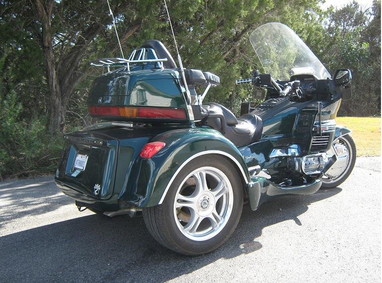

Another thing that may possibly be a bit of an issue for time is the relatively rare color of your donor bike. Our first GW trike was a '95 GL1500SE. It was a one year only 2 tone color in what Honda called Pearl Royal Magenta with Purple as the inset color. FWIW, Honda only used magenta on the 95 SE and Kelly Magenta Metallic on 2004. (our current trike year & color) We don't run into too many folks with the '95 or '04 versions of magenta. Had a heck of a time finding touch up paint for the '95 - took a month to get in the '95 magenta, never did get the second color.
Here's pics of the '95 GL1500SE Motor Trike
