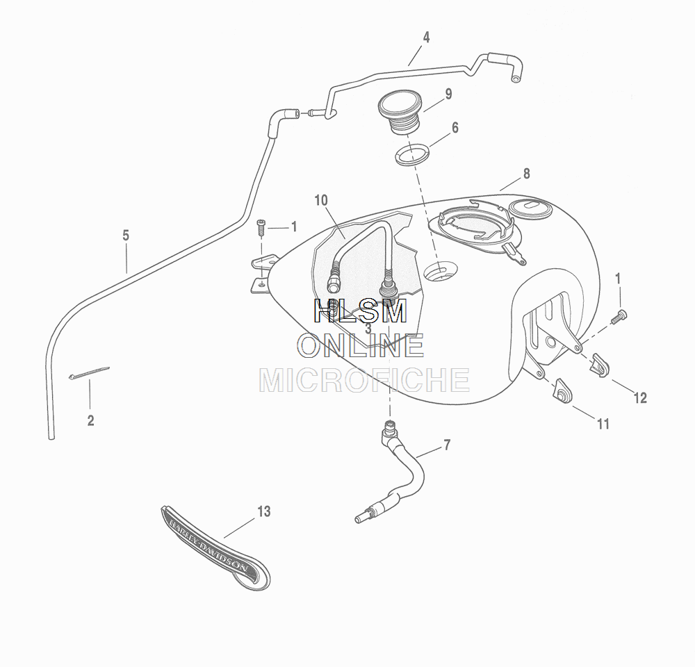

I rode in mid 80's weather for about 26 miles to get home Saturday. When I pulled in the garage and got off the bike I heard a weird sound and after getting closer realized it was coming from the gas tank. I slightly unscrewed the cap and could hear the air hissing from the tank. I loosened a bit at a time until it stopped. I put the cap back on and got a few things from the bike and uncrewed the cap just a bit again and even more air pressure. What the heck is going on? Most of my riding will be in much warmer weather and longer distances when I get moved to Midland in June, so I want to figure out what the problem may be and if it is even a problem or me just fretting. :confused:
Is your gas cap OEM? Your right side gas cap should be the vented type. Possibly there is something wrong with yours.
If it was venting properly, the pressure would not build up.

# 4 and 5 is your vent line, it runs from the tank under the seat down the left side and exists below by your belt
It may be plugged up

I was low on fuel, so I think I NEED to take it and fill it up and ride to see if it does it again. That along with checking to make sure the cap clicked, and trying it with the original (not as cute) cap that is still in the trunk. I knew I needed to hold on the original cap, just didn't know why...LOL!
So is the replacement cap vented? You can order them both ways, unvented & vented.
Hey Jack, Do you know for sure that this is a Harley? It says GL1800 in the Sig.
It's a Harley Freewheeler. There was something screwed up with my signature. I had a signature and a graphic...the graphic no longer appears to exist, but GL1800 the name of the missing graphic was printed. I just took down the dang signature. Too much to deal with...but at least I now know why the question. thanks!
