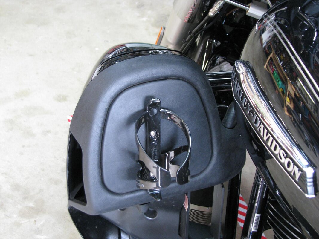

I live in So Cal so a lot of our riding season can be rather warm, and I have riden in Arizona and Nevada where it can get really hot, so I like to have drinking water close at hand while riding.
I have mounted a bicycle water bottle cage to the left side cover, and it works great to grab a drink while at a light or even while riding on long stretches of open road. But to put the bottle back into the cage I have to take my eyes off the road and turn around to locate the cage.

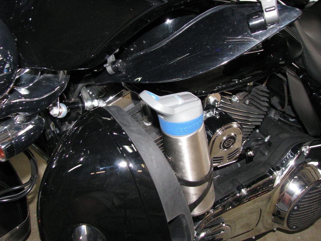

I heard about Hog Troughs on here and decided to try and make my own, and ordered a spare cover just in case it did not work out or in case I screwed it up. On the first try I mounted the cage directly to the pop in cover (first pic) as low as I could. But when I tried it out the left air deflector hit the top of the bottle when I cranked the bars to the left. On to plan B.

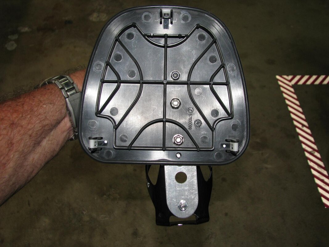

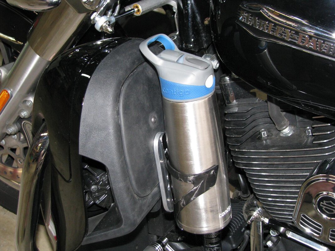

I got a piece of 1/4" thick by 1 1/4" wide aluminum strip and made an extension to mount the cage 2 1/4" lower. I used the original lower hole as the new top hole and to mount the bracket and cage to the cover. I also drilled a new hole at the top of the bracket to help secure it to the cover, and another hole on the bottom of the bracket to mount the lower part of the cage on to.

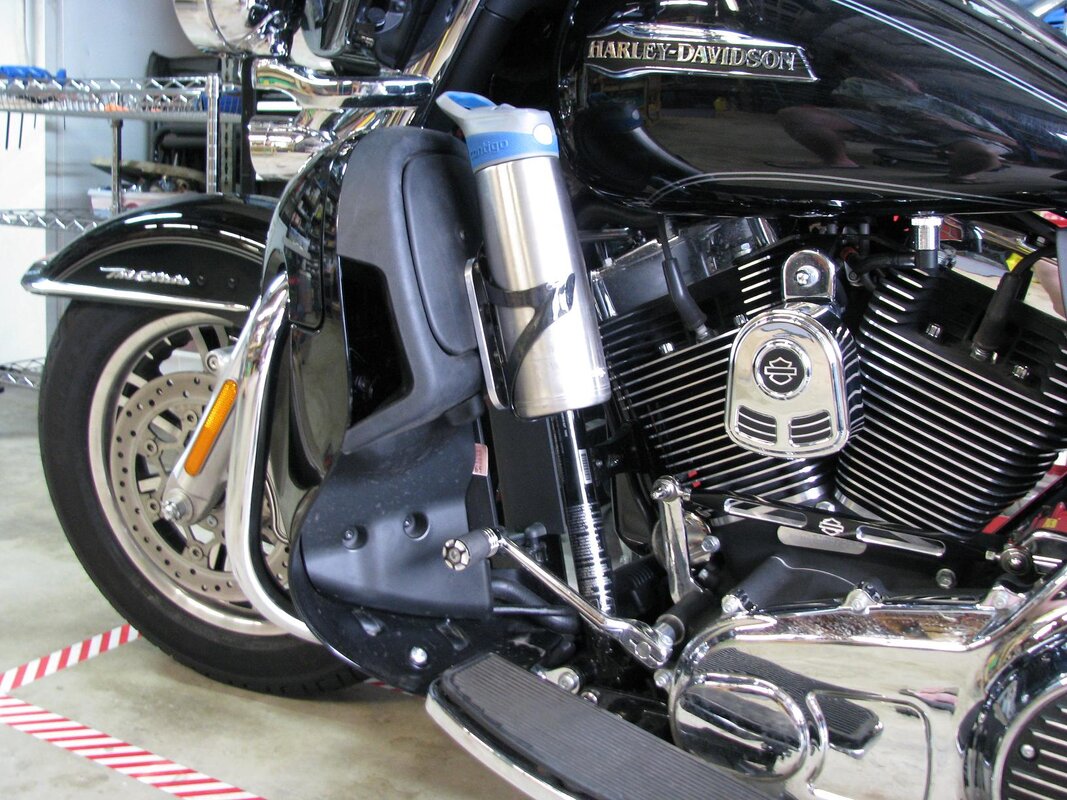

Now I have NO clearance issues and can easily reach the bottle and put it back while keeping my eyes on the road. And there is still plenty of room for my foot when shifting.
It takes a good tug to get this cover to pop out, so I am pretty confident it will stay in place even with a full bottle of water.

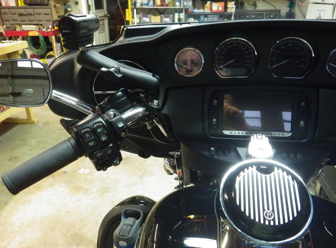

Personally I am not a fan of bar mount or control housing mount water bottle holders, as all of the possible locations would put a bottle either in the way of a seeing a gauge and or stick out/up like a sore thumb. So this unused lower cover works for me as it is still easy to reach, but hardly noticeable.
And like recall stated, there is not much room on these bars, as I already have a RAM mount ball for my Contour camera, and I prefer the bottle be on the left side so I can grab it with my non throttle hand.
I looked at Thermos Funtainers and a plethora of other water bottle and drink containers. But this CONTIGO Sheffield SS double wall bottle with flip up drinking spout is the best thing since sliced bread and the the BEST water bottle that I have ever used.

I can see you couldn't put yours on the left handlebar with that rocker switch in the way so I guess the only place you could put it was on the lower.

I have to take my eyes off the road to put it back, but no longer than any of us take our eyes off the road to look in the mirrors, at a gauge, the Nav screen or at a street sign. And if you can look in your mirrors or at the gauges without technically taking your eyes off the road.....then you are a better man than all of us ;) But IMO this location is safer to put it back than when the bottle is in the side panel holder.

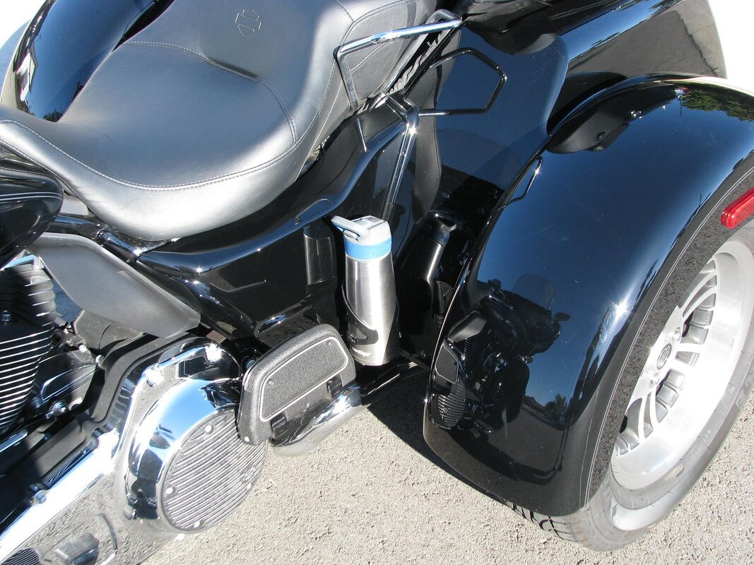

To Trikin: This bottle Stainless Steel double wall bottle does not get hot even when it is on the side panel that is just inches away from the exhaust pipe. It is advertised to be able to hold ice for up to 18 hours, and believe me IT WILL. I rode from Needles to Barstow in 106 degree heat and had cool water to drink the whole way, and then some.
I just got back from a 100 mile ride down to and up Ortega Hwy. I was gone for over 3 hours and most of the water is gone (I drank it) but most of the ice is still there.

I went on a 790 mile round trip ride this past weekend and the new water bottle location worked out great. But....being in a location with almost no air flow and so close to the cylinder, the outside of the bottle itself did get a bit toasty to the touch. The water was still cool to the last drop, but in this location and in 106-113 degree heat the ice melts faster than when it is in the side panel holder (see the second pic in post #4)
