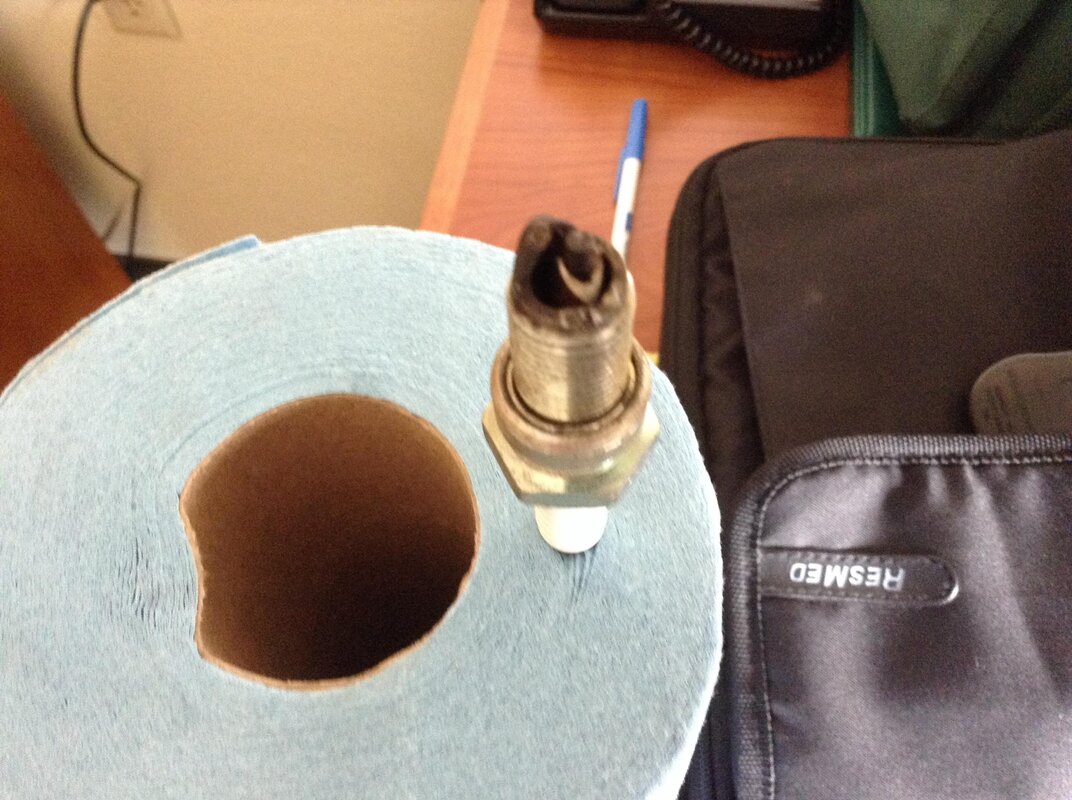

image.jpg After looking at this plug, I took my fiber-optic scope and took a look down into the spark plug hole and saw some kind of damage to the top of the piston. Still not sure what caused this, the timing belts are intact. I suppose I'll have to at least pull the right side cylinder head to see what I actually have.
Interesting. Can't wait to see what you find. I had a plug do that on my car. Came out with smashed porcelain. Never effected the car. Put in a new plug and drove it. I would replace the plugs and try to start it! Does it turn over?
How many miles on the motor ?
once had a dirt bike that lost a chip off the top of the piston above the top ring.. the piece bounced about quite happily on top of the piston for a little while (putting little dents in the piston top, and the head) until it came up under the sparkplug and closed the gap, thus stopping the motor (single cylinder).
if thats physical damage to the spark plug youll need to see what was loose in there, and how much if any other damage its caused.

I did a little snooping around the trike in the 98* sun here in Dallas. Sent a magnet down the suspected cylinder and pulled out a piece of metal. There are more in the cylinder but are bigger than the spark plug hole. I believe it's probably one of the valves. I'll have to remove the head to know for sure. Looks like, at the very least,that I'll need a cylinder head. Maybe a piston also. The next question is what may have caused this. I've heard of belts going bad and crashing the valves into the pistons but the belts are both intact. I'm going to contact the P.O. and see if she can shed some light about what happened to it. So we'll see what she has to say.

Does the timing belt look new (soft Black clean ) ? I betting timing belt change gone bad. Remove all the plugs and send the magnet in . Valves are weaker than pistons. Are the pieces looking like valve pieces. I believe the pistons are aluminium non magnetic .
John, Yep, the piece I was able to pull out with the magnet appeared to be part of a valve. There is another piece that is too large to come up through the spark plug hole (I tried for two hours in the TEXAS HEAT trying to coax it out). It'll just have to wait until I go back to Michigan and can do it in my ouw garage. I'll keep you posted on it. I plan on going to Troupe Texas to the MotorTrike Facility to tour and see if they might look the trike portion over for me to ensure that everything is ok.
