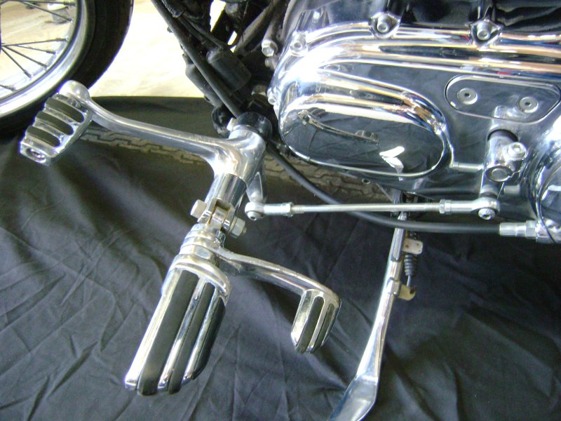

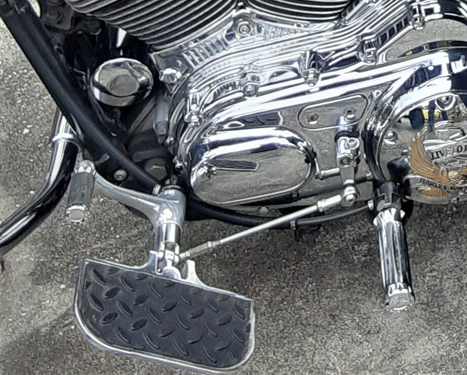

Hi - new to the forum and new to my 2005 Harley Davidson Trike. I need some advice and this forum is real helpful. So - here I go. This is a 2005 1200cc Harley trike - and I want to change to a heel toe shifter. All videos that I've seen have the linkage above the pedal - mine is below the pedal and the peg that the shifter is on now is real short. I'm looking for suggestions and/or help as I really like the heel/toe, but if it's not available for this particular bike, guess I'll just have to get used to it. Thanks in advance for any guidance.
I've attached pics of mine - linkage is below, not on top
Hi Nancy, :welcome:to Trike Talk
Yes this can be done but it will take some fabricating to do
No one I know of is making an out of the box kit for Sportsters
I have seen a few home made set ups. With your set up the first thing to do is flip your current set up 180 degrees Look here first ( not yours but similar)
Next after a flip,
It can be done but you will need to get a welder fab person to help, or talk to a shop that does custom bikes, either way it wont be cheap.
View attachment 104357View attachment 104358

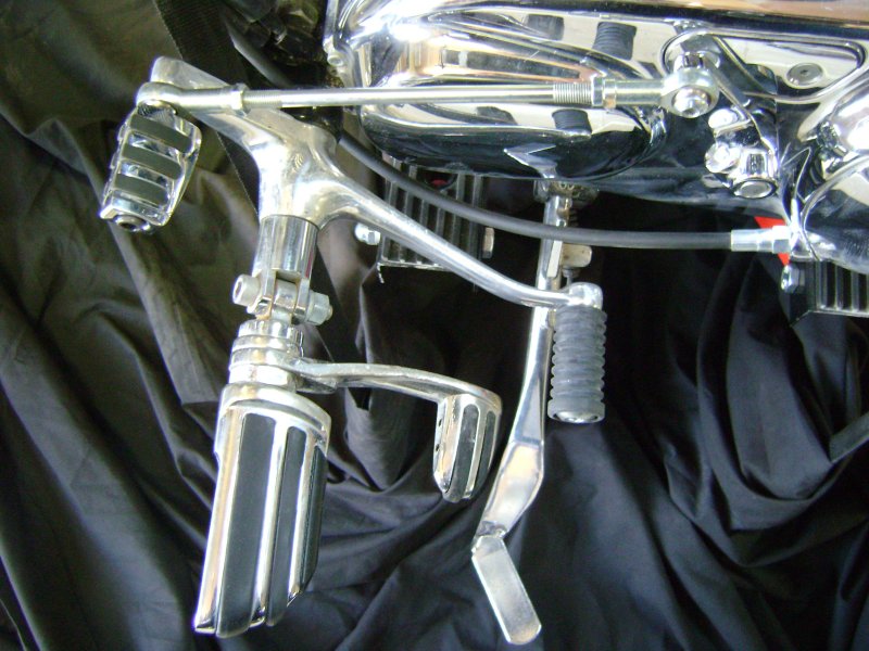

Welcome to the Forum and Congrats on your New To You Sporty Trike.
We have a heel-toe shifter, specifically designed for Sportsters. You can see details and more photos at this LINK.
Here's a photo of a polished version, we also have them in powder coat black.
I've been running these on my Sporty for 6 years now and would not go back to just a toe shifter.
thank you for the link. I'm going to order it and I will be calling you if I have any issues. Truly appreciate your help and guidance.
