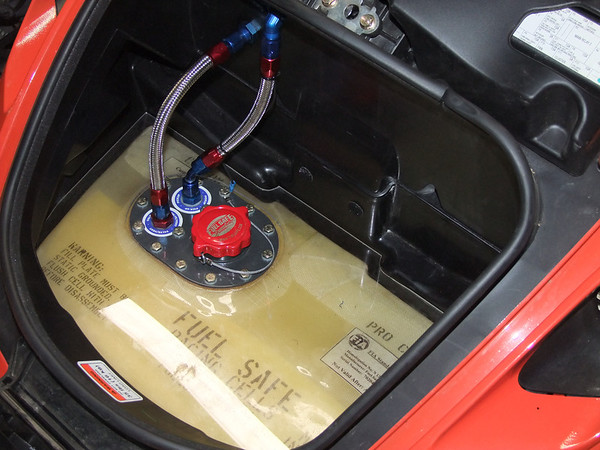

Some curiosity questions?
1. what's the capacity
2. is it baffled
3. why did you use a side fill instead of coming in from the top
My aux tank is baffled and fills from the top so I can utilize it full capacity of 5 gallons. It seems like you've lost at least a gallon. I've never seen an aux tank with a fill in that location.
Like I said, just curious. :wave4:

<div class="message">Some curiosity questions?<br /><br />
1. what's the capacity<br /><br />
2. is it baffled<br /><br />
3. why did you use a side fill instead of coming in from the top<br /><br />
<img src="http://www.triketalk.com/forum/attachments/yamaha-trikes-161/7424d1361459678-new-auxiliary-tank-system-100_5381-small-.jpg" border="0" alt="" /><br /><br />
<br /><br />
My aux tank is baffled and fills from the top so I can utilize it full capacity of 5 gallons. It seems like you've lost at least a gallon. I've never seen an aux tank with a fill in that location. <br /><br />
<img src="http://gargoyle.smugmug.com/Motorcycles/Spyder1374/i-c5SHx5m/0/M/DSCF5533-M.jpg" border="0" alt="" /><br /><br />
<br /><br />
Like I said, just curious. <img src="images/smilies/wave4.gif" border="0" alt="" title="Wave4" class="inlineimg" /></div><br />

</div> Capacity is 5 gals plus. I had a full 5 gal can of gas for a snowblower I dumped in. That amount brought the fuel up to the bottom edge of the fill tube.<br />
<br />
There are two baffles welded inside the tank.
The reason for the fill location is the cap is located in the valley behind the high part of the fender. With measurements I've taken I should be able to bring the fuel level up another 2-3&quot;. After adding the flip top cap the cap will be about a 1/2' higher than the tank itself. I posted a pic of a body back on and cap in place. I may have made the tank taller than neccassary but that just gives more room for venting. Cougar may chim in here on what his tank capicity is. <br /><br />
Larry
Mine is 5.3 if I really work the pump :) Hey did ever tell anybody how much I love my Aux tank? ;-) ANYWAYS I normally just put in about 4.5 or so if the day is HOT I had one time I was on a sideways incline and the fuel decided to want to come out the cap .
That was only one time though. I was park in a very strange spot with a full tank.
I can squeeze 7.2 Gallons in ours :p
My tank is the prototype upon which all the others are built. The final production design was altered for ease of build and final installation, hence the slightly smaller capacity. The system works flawlessly and we have never experienced any fuel loss through either the filler cap or vent line.
YMMV
