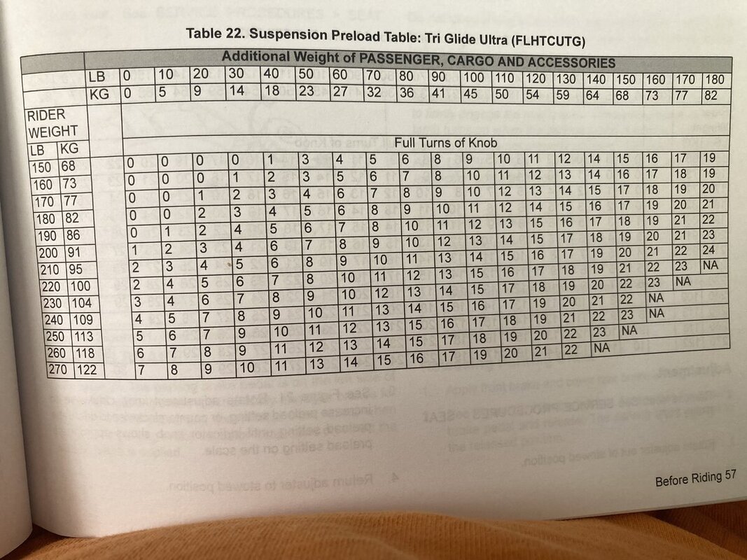

Your best friend is a GOOD pair of aftermarket shocks. I too, have ProAction shocks (there are also a few other good ones out there) and when you purchase them, you give them your total weight and they will be set up for you. (And you can still dial in the spring preloads and “rebound clicker” fine tuning too!

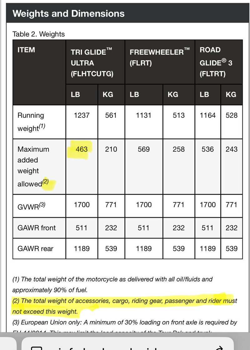

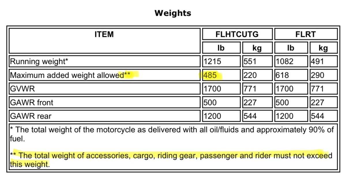

I recently purchased my Tri Glide. Is there a way to increase the weight limit for passengers safely so both myself and the wife can ride? (We are both larger riders)
I have converted to pro action shocks many years ago and I have had conversations with the folks there, especially George Quay president and founder especially of late. I encourage you to call them up, explain your needs, and they may actually offer various spring rates for those shocks.
