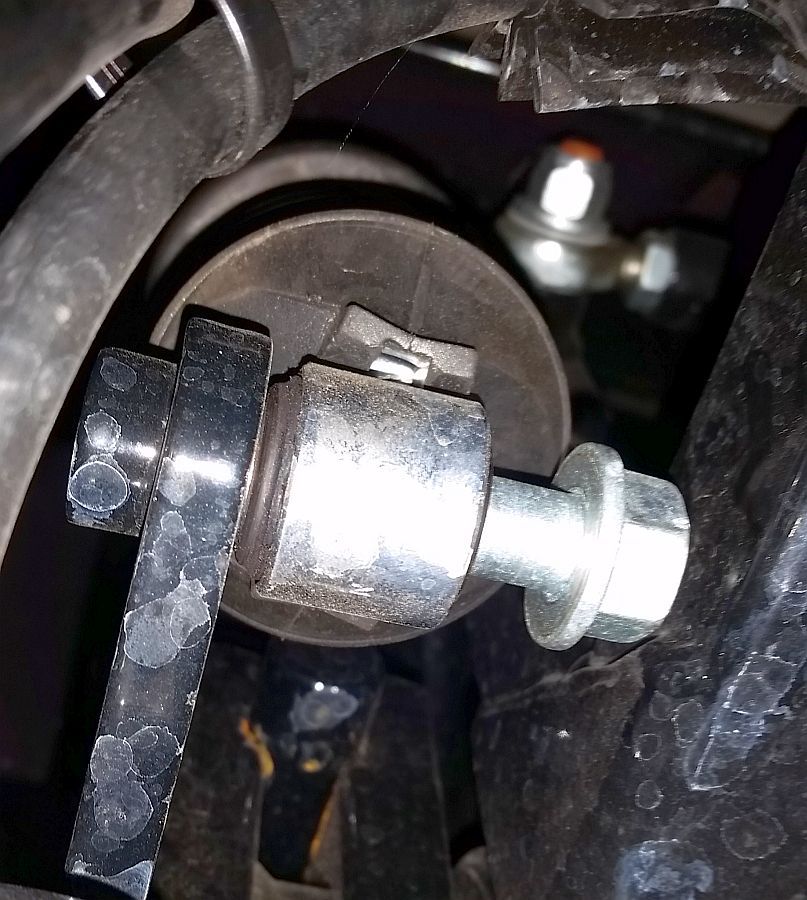

We had occasion last week to be doing some work on a 2017 Tri-Glide.
It was a few months old, with 2000 miles on it.
It had the Dealership 1000 mile service done to it...where they're supposed to change the fluids and check all critical fasteners.
We needed to remove the bottom bolts for the engine guard. They were ONLY Hand tight. Not good.
When we got under the trike, the bottom shock bolt on the right side was only hand tight. Bad pattern developing! :icon_errrr:
Then when we went to the left shock...the bottom shock bolt was backed out almost 1 full inch!!!
Not good at all.
Factory did not put it together right.
Dealer Prep did not catch it.
1000 mile service did not catch it.
I don't know if this is a 1 in 100, 1 in 1000 or 1 in 100,000 thing.
But it is a good reminder to not trust our lives with just anyone doing work on our bikes.
Do it yourself, or if you have someone else do it, make sure you trust them with your life, or go behind them and check their work.

Kevin, Was that ever a SPOOKY set of findings! What is also spooky is that checking the engine guard bolt tightness is not on the 1k checklist for my 2017 TGU. I will be checking mine in the morning. Your findings are the primary reason that I do every bit of maintenance that I am capable of. On my 1000 mile check, the only thing I had my local Harley dealer do was check the torque of the oil pan bolts which I am thinking is a new item for the M8 engines and the torque of the rear pivot shaft bolts on the rear fork that I did not have a tool for or easy access to the bolts that needed checking that were on the 1k checklist.
In the past, I have been more trusting of dealership work but as I have developed increased skill and tenacity to do my own work, I have become more assured that things are being done correctly and right to the factory published specifications. As an added benefit, I am also saving a significant amount of money on my maintenance, having fun in the process and getting to know my trike much better.
I can say when I installed the DK Custom Lift Kit that the shock bolts were plenty tight or I am just getting weaker in my old age<grin>.
Update: Checked the 2017 lower Engine Guard bolts with a torque wrench and a T45 Torx today (06-13-17) and they were within spec at 15-20 foot-pounds (not a lot of torque but more than finger tight). Hopefully, what Kevin found was more like 1/100,000?
