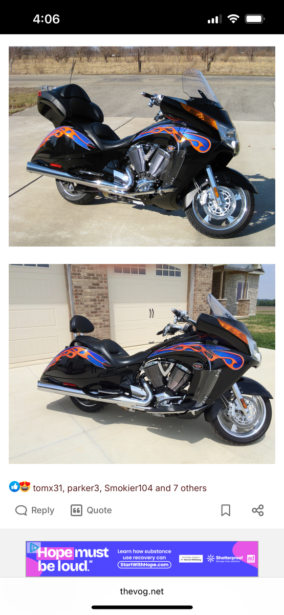

Here’s a couple of pics of mine in both Tour and Street trim. Makes me sad to see it, but went to a really nice couple in New York who still ride it. And if you get on the VOG Forum, I was VMUSA1 on there.
