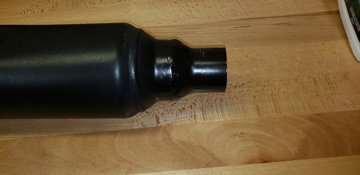

Got the muffler fixed up with a 1.5" inlet. Next step is to get them on the bike. Here is a pic of the fix. I dropped it off with a fellow who had the tools and skills and an hour later I have it back. Just need to cut expansion slots to fit it onto the head pipe.
