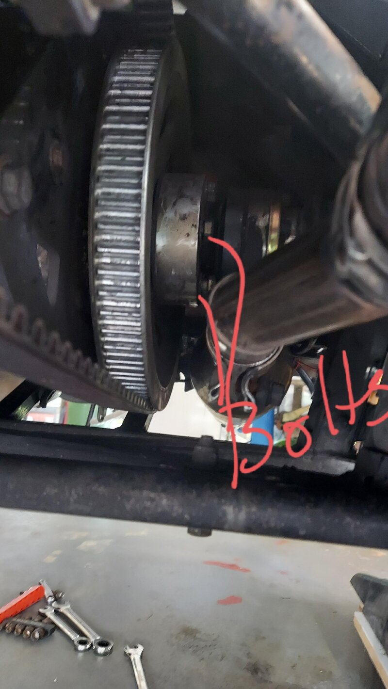

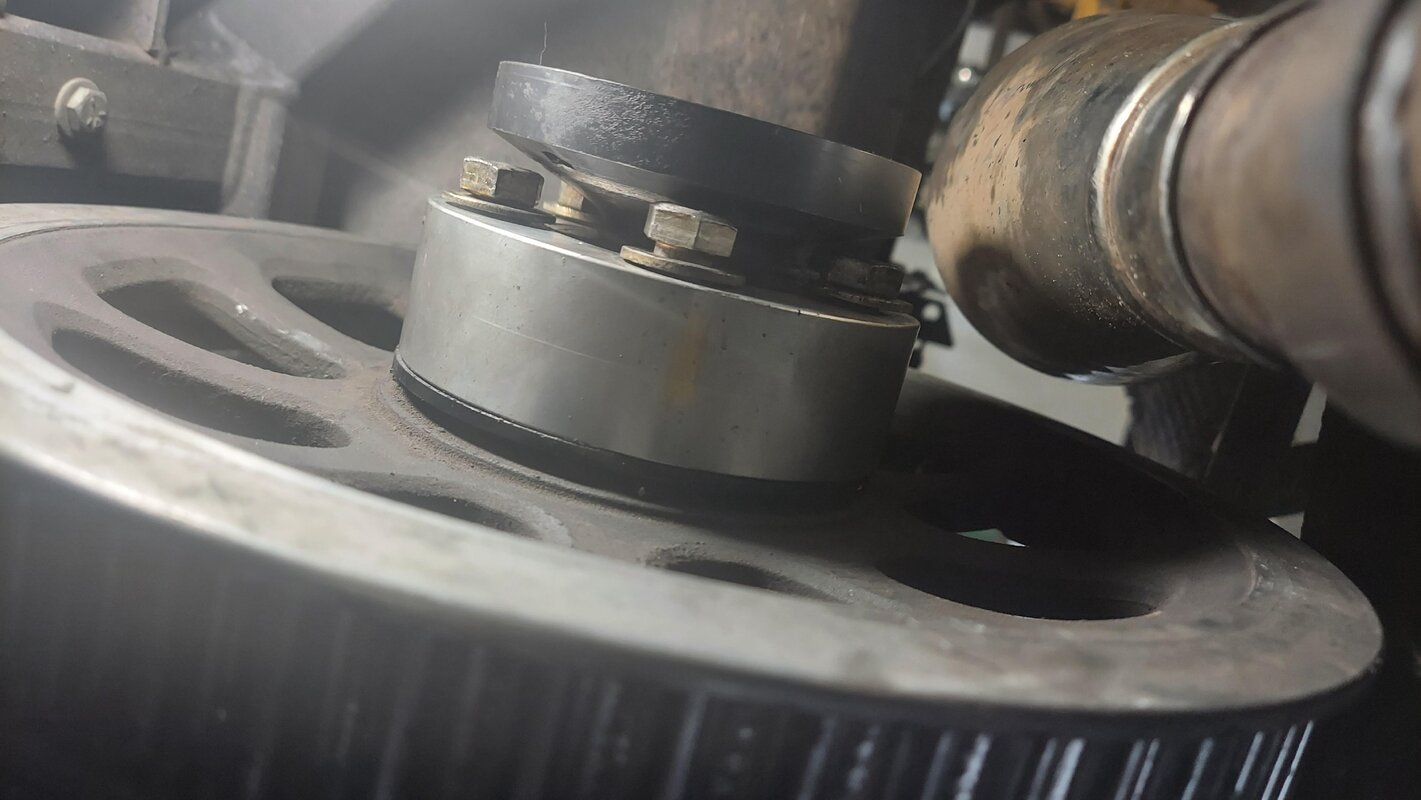

I had a loose Muffler went under to tighten it up & found Loose bolts on the Clutch side of the Drive Pulley.

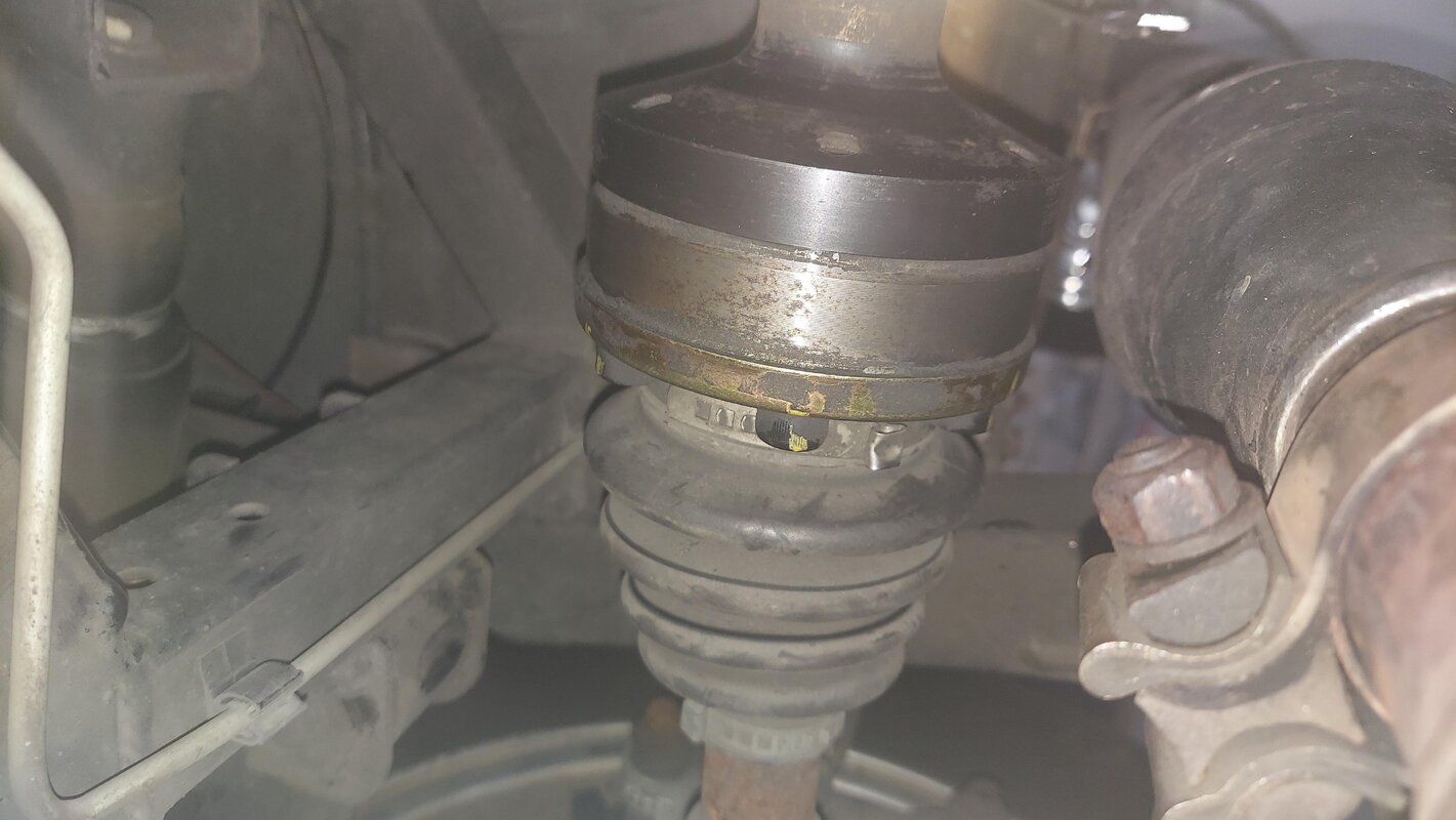

It seemed the inner CV joint was in the way of getting to these to tighten them So, Removed CV Joint.
Only to find that still didn't help.
I'm being told these bolts are done @ Motor Trike & Not @ Installation.
That Motor Trike Tightens them to 70Lbs with Red lock-tight.
I'm Wondering How I can do that when I can barely get a Open-end wrench in there.
Also I can't see the Threads to put the lock-tight on.

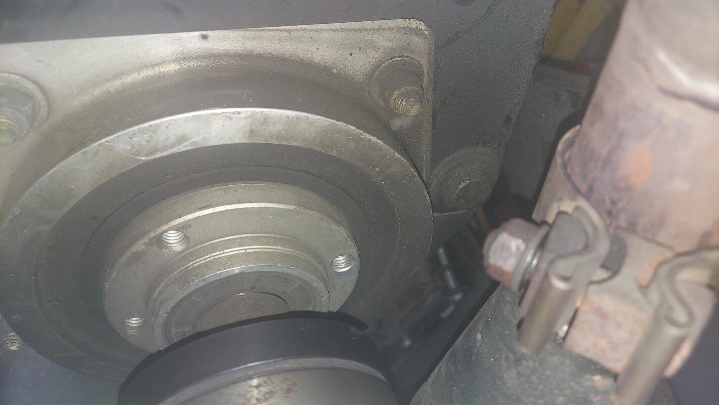

Then after Working on this I see these Bolt holes on the Brake Side of the Bike & start wondering
if I'm missing Bolts here.

I dont have a Gladiator kit but a Trog Kit. I would advise you to remove the muffler and extension pipe from the cross over and take those bolts out, pull the spacer and rear drive belt pulley, then inspect the hub the bolts thread into behind the rear belt pulley.
I had a similar issue with my Trog kit. If the bolts thread into a aluminum hub and the bolts are a sloppy fit or threads pull out with the bolt. You will need to get a steel timesert kit to install into the aluminum hub. plan on replacing the bolts and washers with new. The bolts and washer are a Grade 8 and can be found through McMaster Carr.
Once the bolts back out chances are the bolts have distorted the hub threads and you will not fix it any other way.
Take pictures before you disassemble so you have before pics to review when reassembling.
