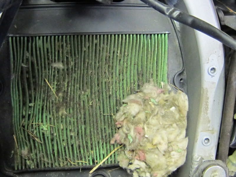

My air filter. 19k on bike.
They get to the air filter through the inlet of the intake air duct. I took the intake air duct's out, and put 1/4 inch hard ware clowth over the inlets of the ducts. No way can they get to the filter now.
